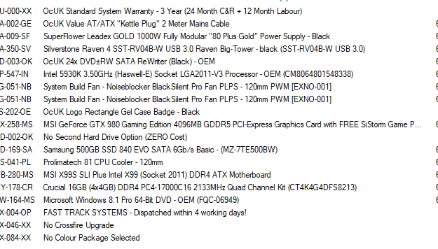

here is my spec pc
New system? New problem? How long has the system been running before the issue started? Have you changed anything hardware wise (new HDD, whatever) since you've had it?
The system is 6 years old, the problem has been happening for say around 3 months, only additions by me is the 1080 card and an extra ssd, both of which I fitted last year, I have reinstalled windows as well recently to see if there was anything corrupt there.

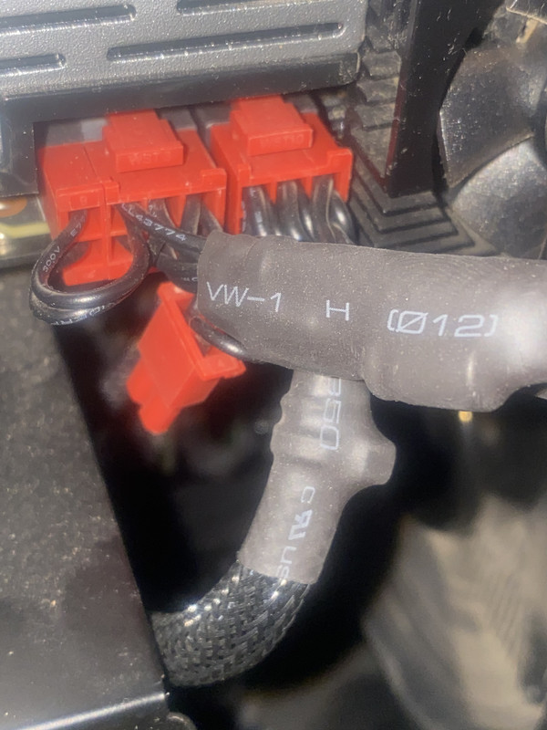

I have one power lead coming from the psu to the gpu and from that a chain lead to the other socket on the gpu,

Start with the simple things, checking your connections as above and making sure you're not daisy chaining the power supply if your GPU requires two sets of connectors. A bios update should be relatively safe, but were it me i'd run the system on the iGPU during that process just for some certainty of stability. That said, i'd exhaust other testing(problem solving) measures before doing that, given that the system has ran fine prior.
Presumably you have spare cables (i'd be surprised if that's not the case with your PSU), hook up a second VGA power cable instead of daisy-chaining the single cable and see if that helps with the issue.
For clarity, you have one cable labelled either "PCI-E or VGA" from the PSU that feeds into the GPU? (it doesn't necessarily look that way in the image) If yes, find the spare/additional cables for your PSU and hook up a second VGA/PCI-E express cable in place of the daisy-chained connection.
You should have a bag of spare/additional cables for that PSU, it's a fully modular gold PSU.
Black branded bag of cables (you get that with EVGA/Superflower gold PSUs).
Just to add a little personal experience in, we have superflower leadexs in two systems now(at home), the lower end system has a (my old GPU) R9 270X which requires 2x6 pin connectors. I tried running that off a single daisy chain PCI-E connector from the PSU(because one connection is easier/cleaner than two) and it wasn't having it, immediately solved that adding a second cable.
Both PSUs, Leadex II and III came with two sets of VGA cables, i'd expect 4 with a 1000W version, i had 4 lots with my previous EVGA 750W (which i can be certain of because i ran crossfire 270x and i remember the volume of cabling as a result).
