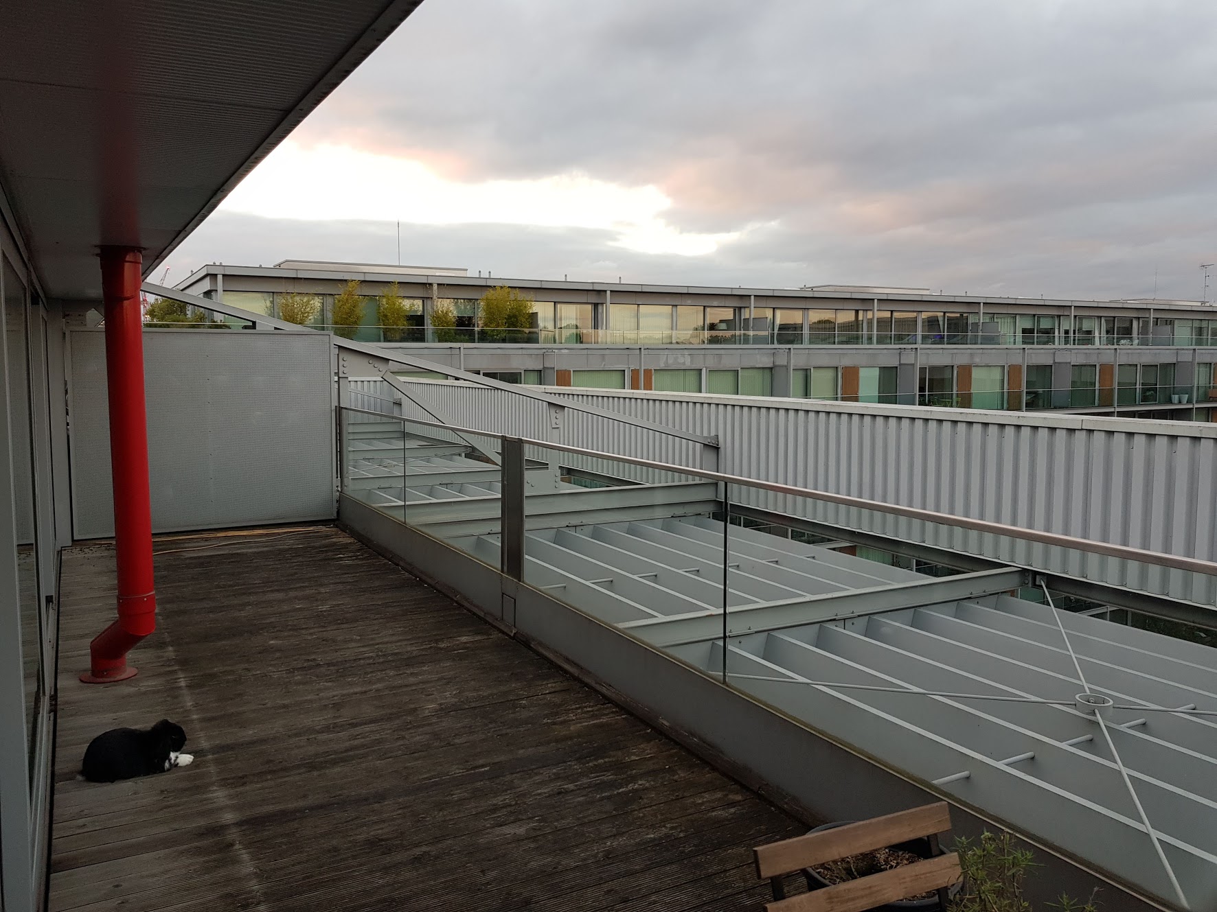

We replaced our wooden decking with Millboard last May, and a year on without even having to clean it, it still looks absolutely amazing. It feels far nicer underfoot too, doesn't get slippy, and is generally just really great:
https://millboard.co.uk/decking/enhanced-grain
Before:
During:
After:
