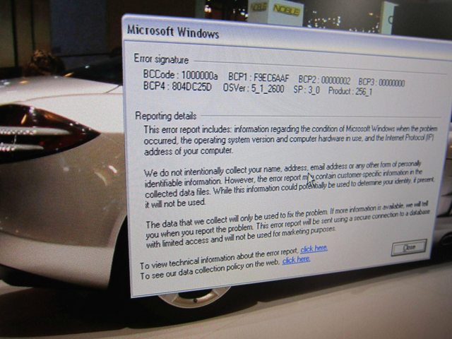

When I first turned it on when Dad brought it home, it had one of those "System has recovered from an error, send report etc"
And I will post some screen shots of that error details later when I'm back upstairs.

Turned it back on and got this message (the first two are from when Dad brought me the PC), second two are after the most recent reboot. How do I find more info about this?
Thanks (see images below)

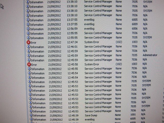

I went into event viewer as you suggested and this is what I found, although like I said I'm not sure what I should be looking for in there. There was some errors though (see below)
This was under 'System' and the pic below is from double clicking one of the errors:
And this was under 'Application' and the pic below is once again double clicked on both of the errors:
This is the one from IE crashing above and Malware bytes anti malware below:
Do you have any ideas what the problem might be? Do you think an OS re-install is necessary since it didn't actually complete the anti virus scan (IE crashed and rebooted the system) so I don't know if there is any malware or virus
