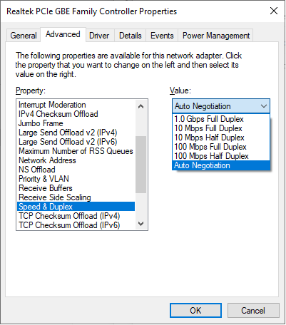

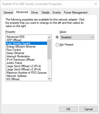

Might be worth just checking these options in the adapter:

Ok but what about the driver (will test without powerline)
