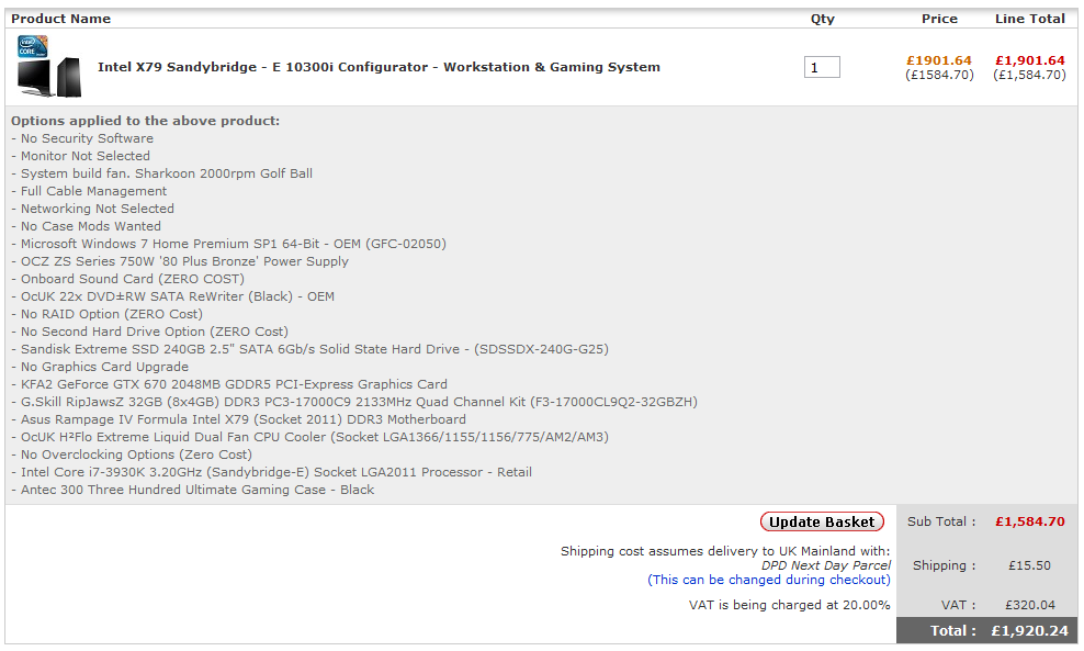

stulid - I'm not sure just yet which is why I'm on the forum, I'm unaware of how powerful some of the OCUK pre-built machines would be for After Effects or whether they'd only be any good at games, therefore would have to spec up my own system.
I've never been afraid of swapping drives, RAM, Cards etc on my Mac but building a PC from scratch may be a bridge too far as I'd need it for work.
Just did this in the Configurator so it is very flexible, I think with your needs you may want to call up OCUK and ask their advice about it though.
To explain that, it is basically
- Upgraded CPU
- Upgraded motherboard
- 32GB RAM
- 240GB SSD
- No sound card (onboard sound)
- No extra storage
- They build it for you and overclock it for you at a price, the higher the overclock and the more components need overclocking the more it is, but the faster it is!
- Fully cable managed
- Warranty
- They test and make sure it runs smoothly
