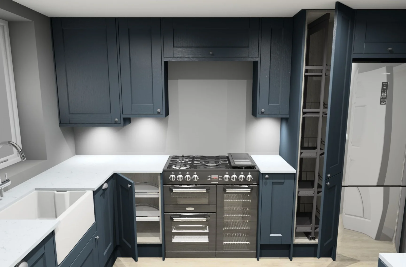

We're putting a 90cm range cooker in the new kitchen (not my choice) and I need a new hood to go with it. There's currently a chimney style hood installed and I hate it as I'm forever banging my head on the corner.
The new kitchen units include a box unit for an integrated/canopy hood but I'd like to know if there are any benefits to having a chimney hood over a canopy hood? It will be vented outside. Current shortlist is either the Bosch, Elica or the Rangemaster:

The only real difference is style, rather than any performance difference. You need to ask yourself if you want to make a feature out of the extractor or just have something discrete?
Personally, over a range cooker, I would think the chimney hood would be the best match.
I quite like the integrated look, plus I won't continually bang my head on it. The colour isn't correct but the design is.

Get one that covers the full hob at minimum. Smoke disperses it doesn't just go straight up.
