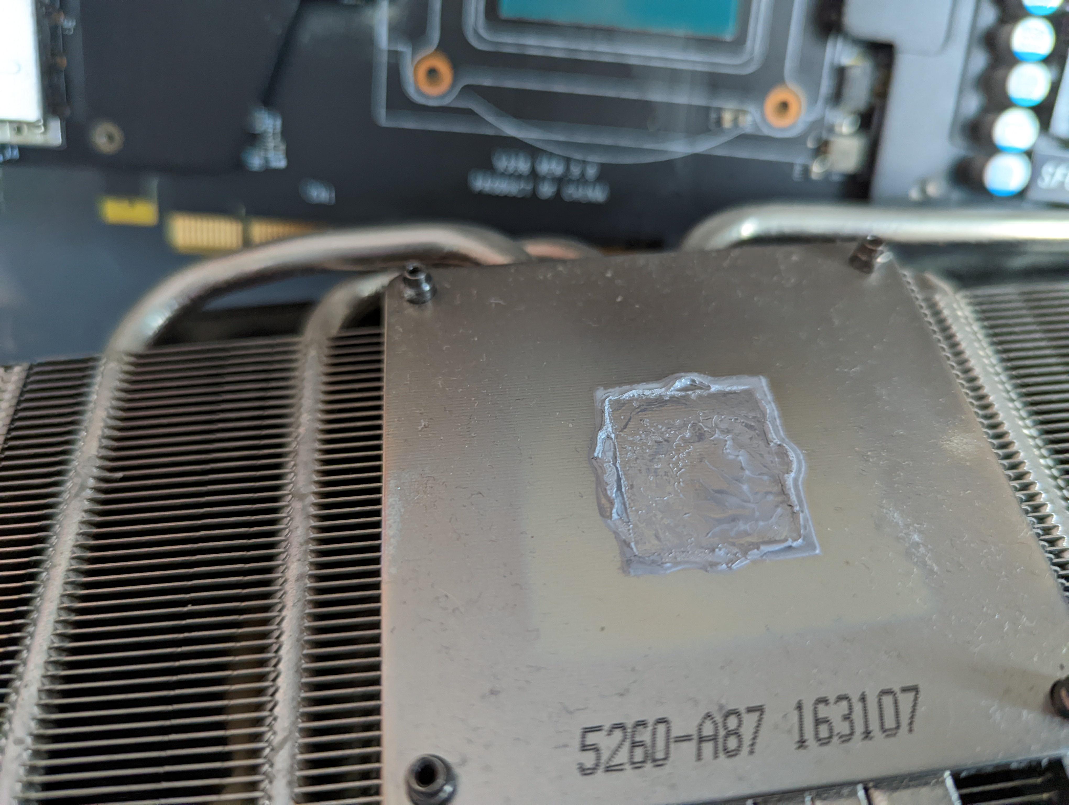

I bought a MSI 1080 from the MM a few weeks ago. I just got round to gaming on it yesterday only to find that it was hitting 90C+ and 100% fan after about 10 seconds :eek:
First thoughts were that previous owner had replaced the heatsink after water cooling, however upon closer inspection the security sticker is still there.
I decided to re-paste regardless and this is what I found...
It barely had a 50% covering. God knows how long it was used at full pelt, throttling away. Anyway, it took 20 minutes to re-paste it and it's nice and quiet at 65C.
Moral of the story; don't assume they've done a proper job in the factory, although I wouldn't want to be risking the warranty if I'd just bought it new.
The covering looks good, you've got goop across the entire surface of the die. Its most likely just old paste that's dried out and lost its performance. Then things spiral, as the temps gets higher the paste dries out even more etc...
Thermal paste is only there to bridge the imperfections between the two mating surfaces. So you could easily say that less paste is better, because the two surfaces contact well.
Glad it was an easy fix for you, and its always peace of mind when its done correctly :)

Yep, paste looks old and dry thats the problem. Clean and replace and enjoy 20c lower temps

Yes, fair comment on the age and the fact it's more a case of the paste being dried out - however I've used older cards that haven't had the issue as bad as this one.

Yea, that's probably the main point I was trying to make - it's not so much the fact it was performing so badly, because it's a second hand older card and won't be perfect. It's really the huge improvement that 20 minutes and a little blob of paste makes, it's well worth the effort.
If that's what you think is 50% covered, you have probably put to much on when re-aplying. You might want to watch a few noob guides for applying paste

I might be dyslexic, but I know how to apply TIM ;)
