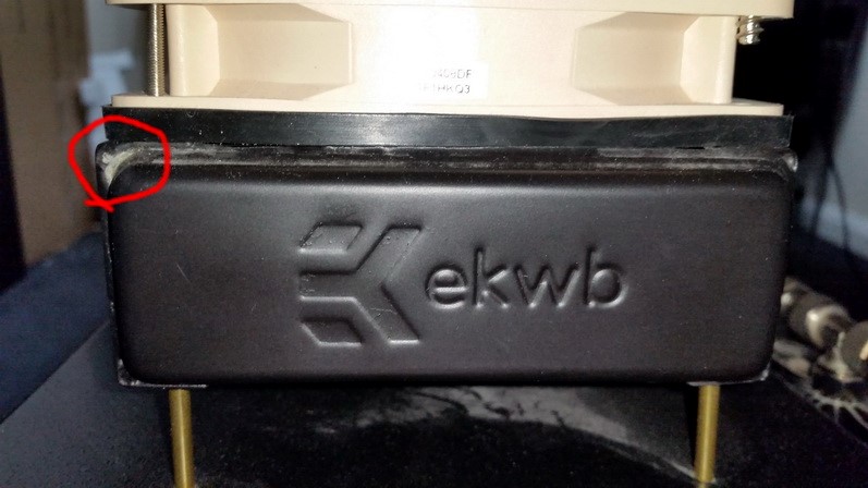

Fairly sure. Did lots of rocking to get the air out of the rad - which is mounted horizontally on the top of the case with ports facing down. Pump is generally running at 8V which gives a flow of 74 l/h so if there's any air stuck there...it's staying there. The tubing I didn't change is quite old. It was stiff and inflexible even when new - which is why I used it on the outside of the case. It's probably a good 7 years old but apart from a slight discolouration from the coolant it's still clear and not furred up. There is a bit of crust in one corner of the rad. Could it be weeping really really slowly?
Coolant temp is around 30 under load. Probably a bit higher if really pushing it but nothing excessive.
Turns out that coolant is 34 in the summer. CPU and GPU are 39. This is normal workstation use rather than gaming. Fans are all running around 800rpm for peace and quiet.
I've scraped off as much of the crust as I can and applied some of my trusty LS-X leak sealer. I know it's good because the first centimetre of the tube had set solid leaving the rest perfectly fine. Had to drill through the set stuff to get at the good stuff! Hopefully this will stop the evaporation...cannot really call it a leak as it's not even dripping! Will have to check it again in several months.
