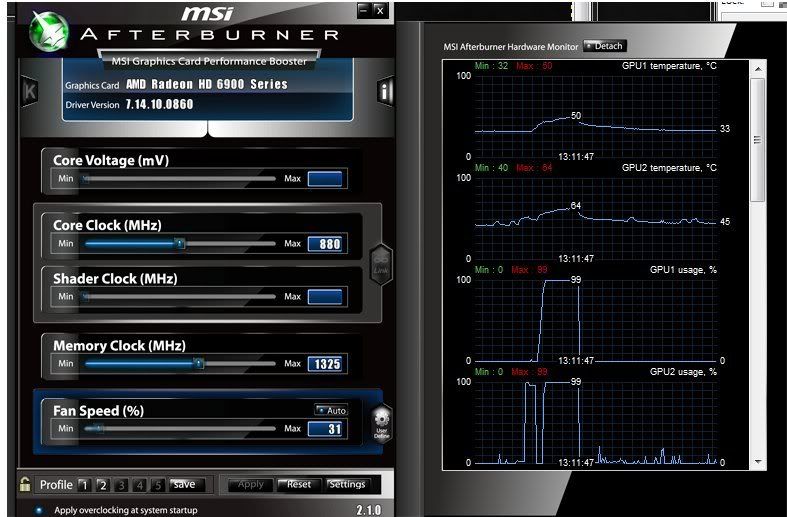

i have the sapphire and a TFIII in XFire, got both running at 6970 speeds(no extra shaders), under high load, the TFIII runs approx 10-15 degrees cooler and significantly quieter, gonna get myself a 2nd TFIII and flog the sapphire.
the dual fan is by no means a bad card, however its a lot louder than i expected.
idle temps are roughly about 10degrees difference give or take a few degrees, load temps are around 15 degrees difference.
looks good, perhaps the sapphire is running hotter due to airflow? u tried switching them around? or running them in single mode for comparison?
Airflow not an issue here, if anything it should be the TFIII that would have poorer airflow plus the heat dumped from the sapphire.
2 different cases in both positions, and always get similar results, not tryed them seperatly yet however, nor do intend to, the temp difference dosnt concern me too much.
