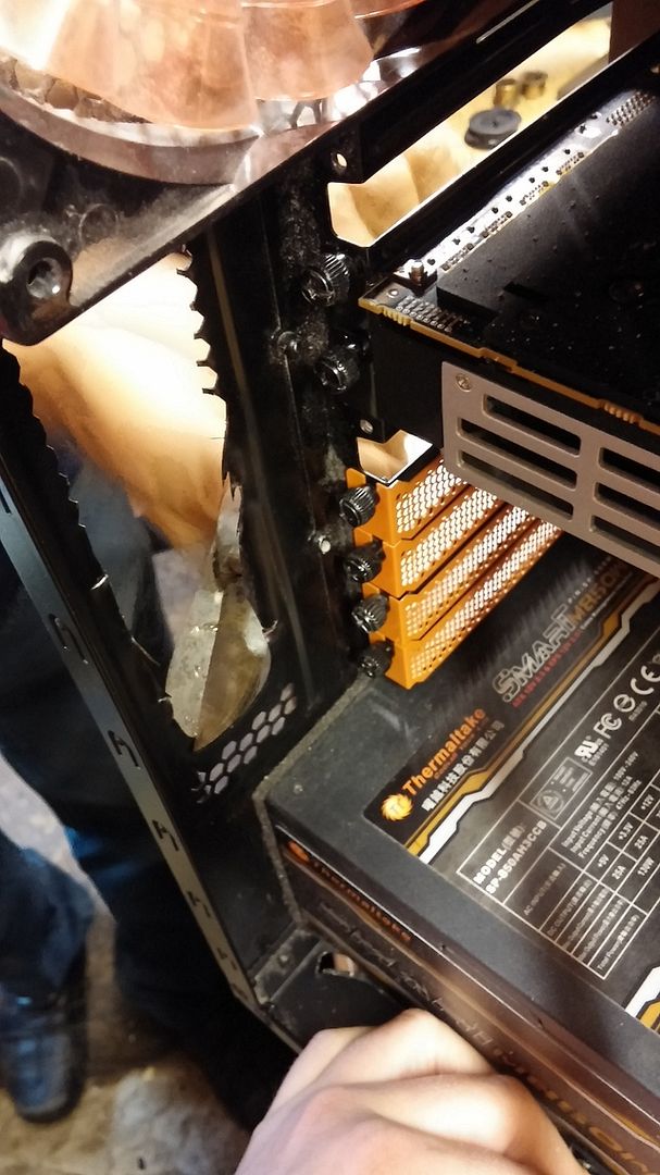

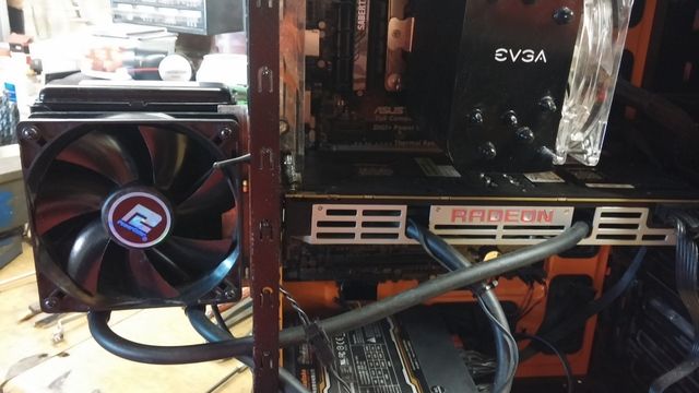

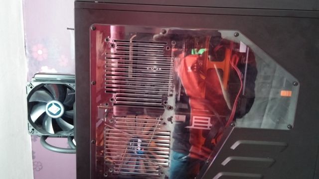

Recently got a 295x2 and was struggling for where to put the rad i wanted optimal cooling without heating up the cpu so i decided that the only real place to mount it would be outside the case! Some will hate the basically bodge job nature of this idea, but i wanted to cool it better for zero cost. I like to mess with things so its worked out rather well.
I had to send the cables through the rear of the case, i couldnt/didnt want to take them off so made a slot in the case just wide enough for it to fit without the fan on. i made sure all the edges were smooth to not damage the pipes. after that i had a small piece of angled aluminum which i drilled and then drilled the case simply put it all backtogether adding a second old fan i had laying around.
Firestrike ultra topped out at 65c with a modest overclock on the card

Nice, don't think I could face cutting holes in my case but top quality bodging there and from those temps looks like it works pretty well :)
Doesn't bother me,its a lot tidier then in that pic now its done and they were only vent holes anyway. The only other way to get similar cooling was a new case or a aio for the cpu and then mount both rads at the top of the case. not enough room with my tower cooler on there now.
I don't think I have ever seen one hung in that orientation before. Usually they get mounted where the 120mm exhaust fan goes. Nice to see ghetto mods are still alive and well. :D
Careful with those sharp metal bits! Would a couple of better fans not be sufficient?
There are no sharp edges anymore that was just after i cut the case, i rolled the edges back so they are basically smooth. Also added a small rubber edge around where they touch the most.
bf4 maxed out is only hitting 55c, i could have got better fans but i still was struggling for room to mount the thing. this cost me nothing and works better! happy days!
