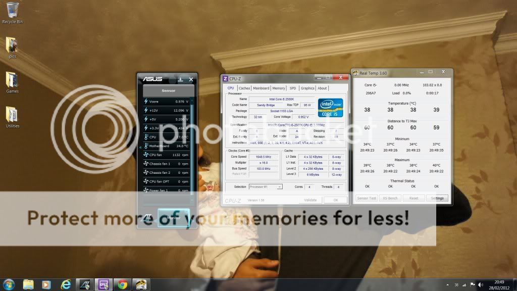

im experiencing slight difficulties and concerns. using CPU-Z it shows the core voltage to be 0.952-1.000 V and the Core speed to be 1648.4mhz.
please advise why it is showing so low?
i then received a Warning message (Asus) 3.33v 0.000.

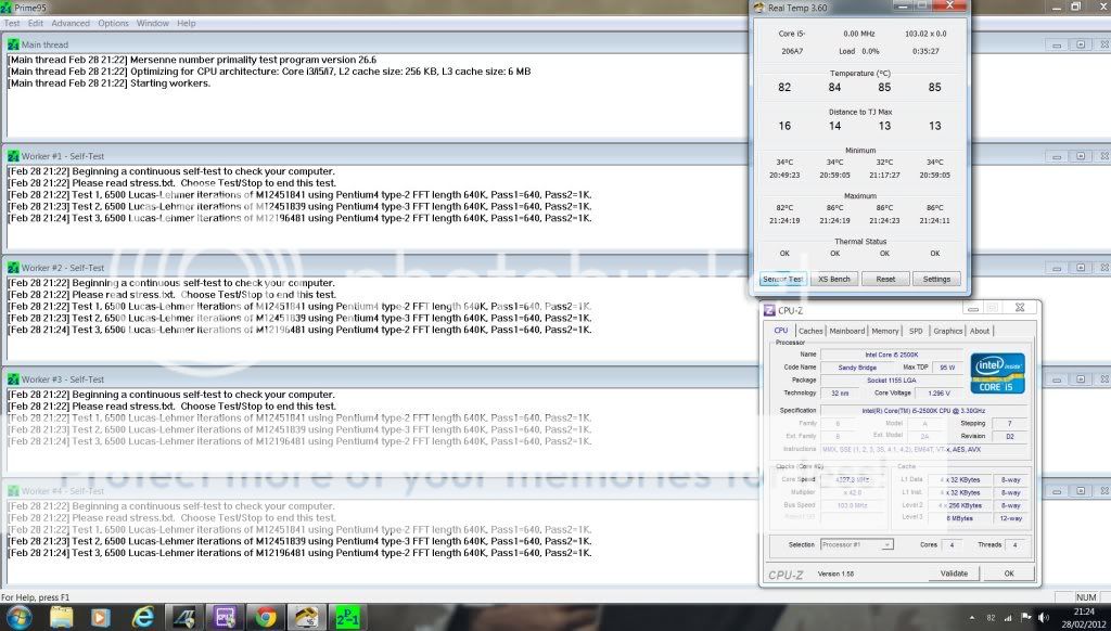

i will run a stress test in a few moments.
i will post a screen shot off the stress test if you can advise if it is ok?
what would you put the Warning sign down to?

Personally, I would reset it back to stock speeds until you get a new cooler, since 86 degrees after only a few minutes at 100% load is really too hot. Also, I wouldn't recommend running the BLCK at anything other than 100MHz.
