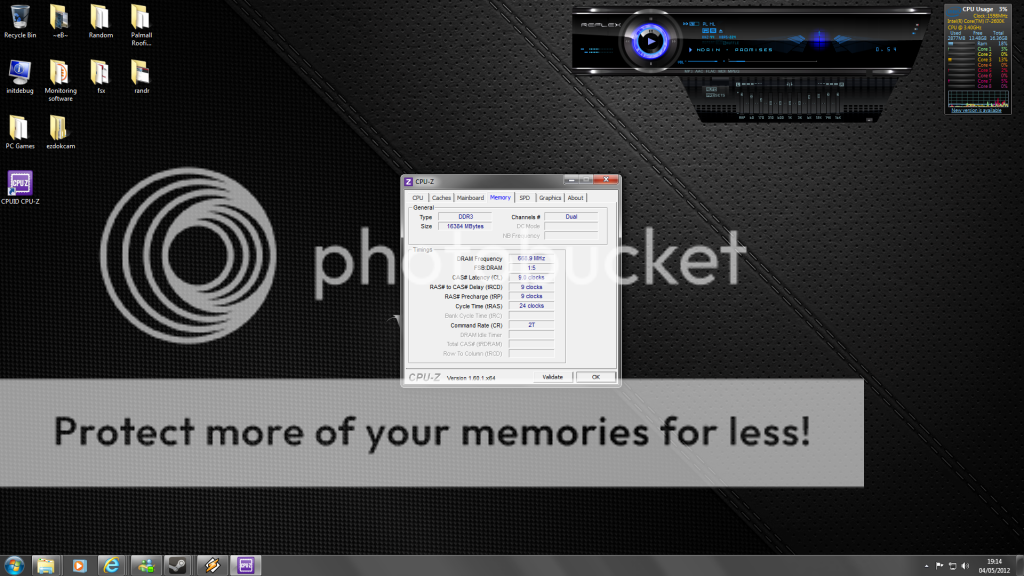

I have 16gb corsair vengeance memory with 8-8-8-24 timings and 1600mhz.
When running cpu-z it is displaying 9-9-9-24 and the speed is 668.9mhz. Is this right? When i had 8GB of ram it was showing the advertised timings. Mabye something to do with the extra 8GB ive just added? Have i done something wrong?

It's not quite right.
Go into the BIOS and enable the XMP profile.
If it's 1.5V RAM leave it at that.
If it's 1.65V RAM try setting the DRAM voltage manually, try 1.55V to start with and work from there.

Right just done some tests and Surveyor is correct ! ;)
But what does help just a little if you can do it, is drop
the command rate to T 1 from T 2 i got a little boost from that but mem speeds nope! :D
