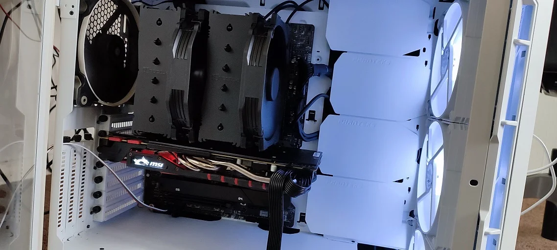

Personally have a d15 and not worried
here's mine and if it somehow managed to bend the motherboard by pulling the motherboard screws out of the case then it would rest on the GPU anyway
didn't even feel that heavy to me, it's not like it's a solid object without the gaps for airflow it would probably be less than half the size
