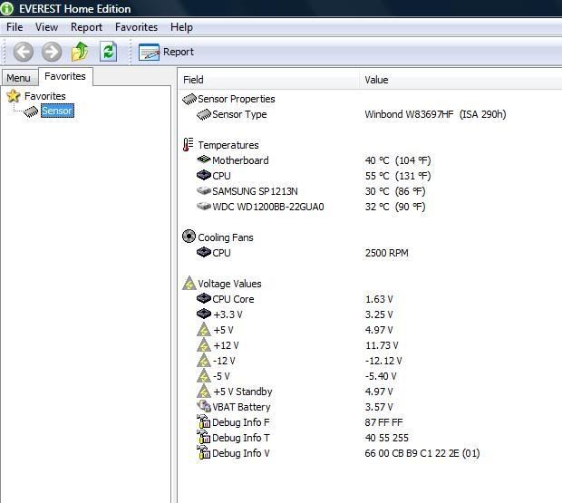

rite i have a standard clocked amd athalon xp 3000
at the moment the cpu is running 55C and motherboard 40C

Should make a reasonably good difference.
55C is about the limit for the Athlons - much higher and they start to suffer. Is that idle or full load?
The motherboard temp of 40C (I assume this refers to the Northbridge) is OK, but not brilliant. However that HSF etc won't do much to cool it - you'd need a NB specific cooler for that.

im not sure if thats northbridge but i assume it is im using mbm5 to monitor the temp.

So nearly idle then. Yep that is far too warm, and that new HSF setup should sort that out quite well :)
You might find that the extra airflow in the case created by the new HSF will help keep that Northbridge a tad cooler. How is it cooled at the moment? Active or passive?
Another thing you should look at is your ambient case temps - if there's not enough airflow through the case then your temps won't drop much, even with the new HSF.

well all arrived and idle is now 41-42 compared to 60 when i took my heatsink n fan off
used the thermal grease that came with it untill my arctic silver turns up.
but using stress prime now while using net and the temp is only 44c so far.
