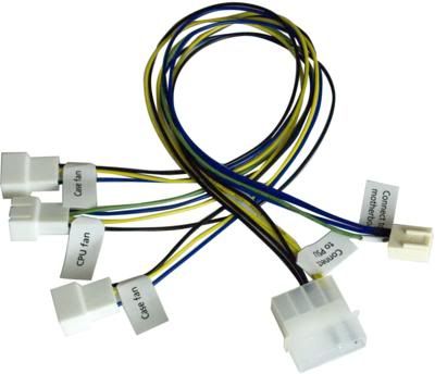

Yes, if they are both PWM fans using a PWM splitter cable, they must be the same make + model or they will just spin at full speed ie- x2 Vipers. Or you can use your Venon on the CPU header and the Apache on another even at full speed the Apaches are quiet.
+1 for the akasa pwm splitter, fantastic little cable. Ive used it for a few years now with various pwm fans.
Another vote for the akasa pwm splitter. I've currently got three Apaches running off one and it's probably the best few quid I've spent on the computer. Do note however that as it comes, it is not a tidy cable. I just spent a while taping all the wires up into appropriate groups but due to the way Akasa have wired it it's a real mess. When I have time I'll braid the cables into groups and re-wire the plugs to get rid of the tangles.
it may look like this in the product image....
but 30 seconds after opening it WILL look like this....
:p:p
all joking aside tho, it is a great little cable. I have this same cable running both my vipers, and as I previously said i don't notice them unless I'm running prime or IBT
I have the same splitter cable running 3 vipers, 2 in push/pull on the venom cooler and one as exhaust and I don't notice them unless I'm running prime or IBT either.
FYI: I did have an apache and the stock ALC eco fan (1850rpm) on the akasa PWM splitter and it ran both fans fine from the splitter. Both idle around 700rpm full load the apache hit 1350 odd and the alc fan hit 1600-1800rpm.
