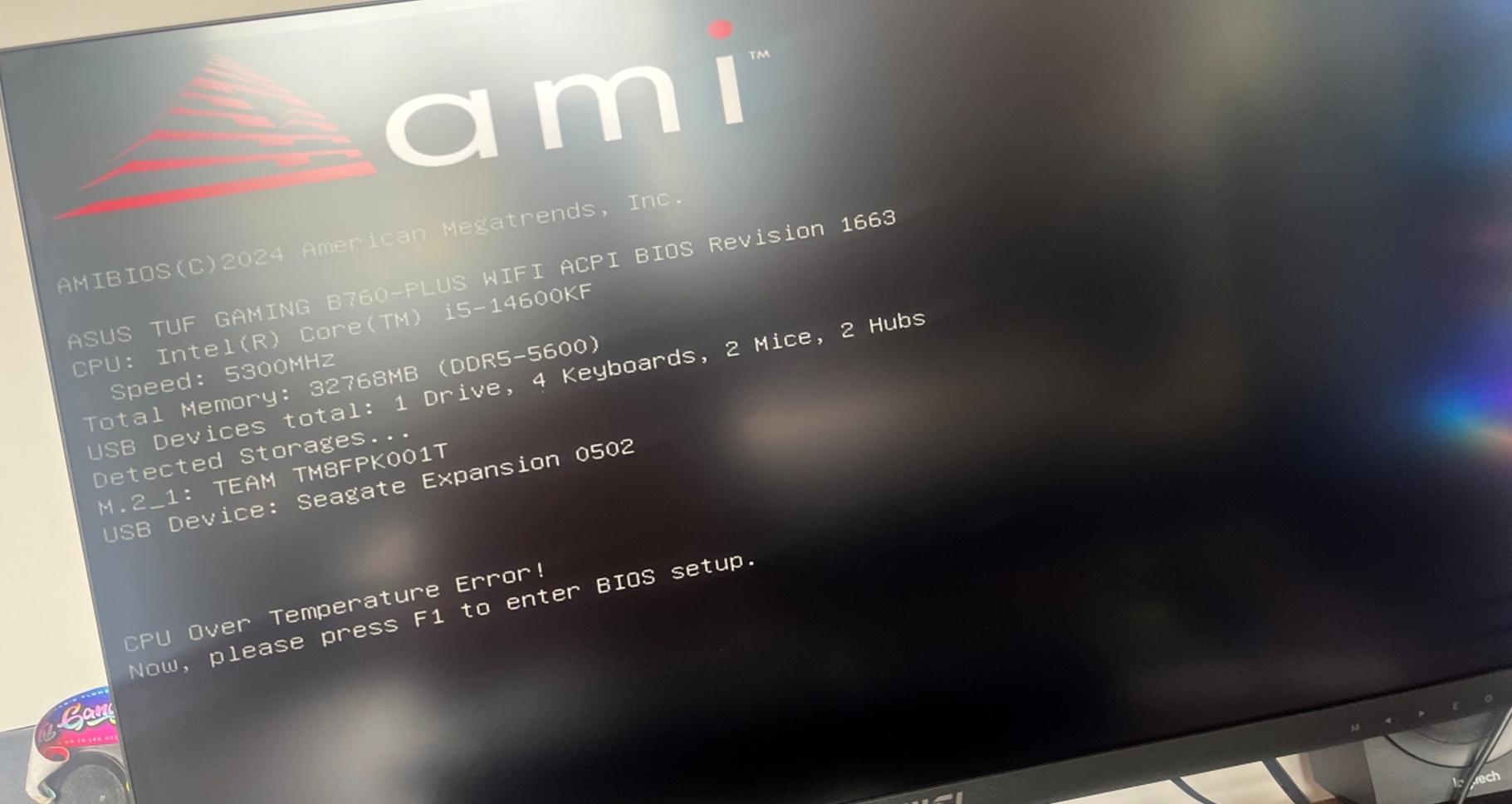

Need Help: Red CPU LED + Extreme Temps on OcUK Gaming Fluorite
Hey all, looking for advice on a weird issue with my OcUK Gaming Fluorite build.
  • Symptoms
  • Red CPU LED stays lit on the motherboard
  • PC gets dangerously hot — fans ramp up and it sounds like it’s about to explode
  • CPU temps spike to 80–90°C, even with minimal load
  • Occasionally boots "fine", but the loud whirring and temperature spikes still happen randomly

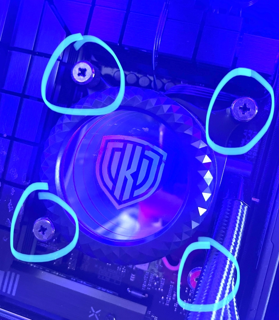

It may sound silly, but is the protective coating removed off your CPU's heatsink/waterblock -whichever you have?
Is the CPU's heatsink secured down tightly?
Are you CPU's fans plugged in properly on the motherboard?
It was prebuilt so they would have taken off the protective coating? as i havent done that.
These are loose. shall i tighten them? the fans looked plugged in properly.
Yes definitely, but do it in a sequence, like top left, bottom right, bottom left, top right.
As others have said give OCUK a call and they can get it all sorted.
That's what the warranty etc is for
Could be an issue with the pump on the AIO that may have failed
Is it ok on cold power up? Go straight into BIOS and see if pump is spinning, you should also be able to hear it, hold a screwdriver to the pump and then to your ear.
Even if the pump is dead it should be ok for for 30 seconds or so to determine the issue in BIOS.
