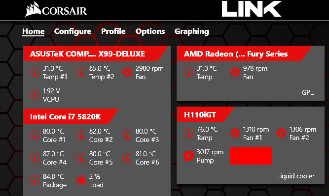

I have a corsair H110i GT that's now idling my system in the high 60's at stock speeds and mid 80's when overclocked.

It's currently idling in the high 60's, and so is the pump. The pump is apparently at 64 degrees as well, and also at ~3150RPMs. Although if I change the pump speed lower the temps skyrocket even more.

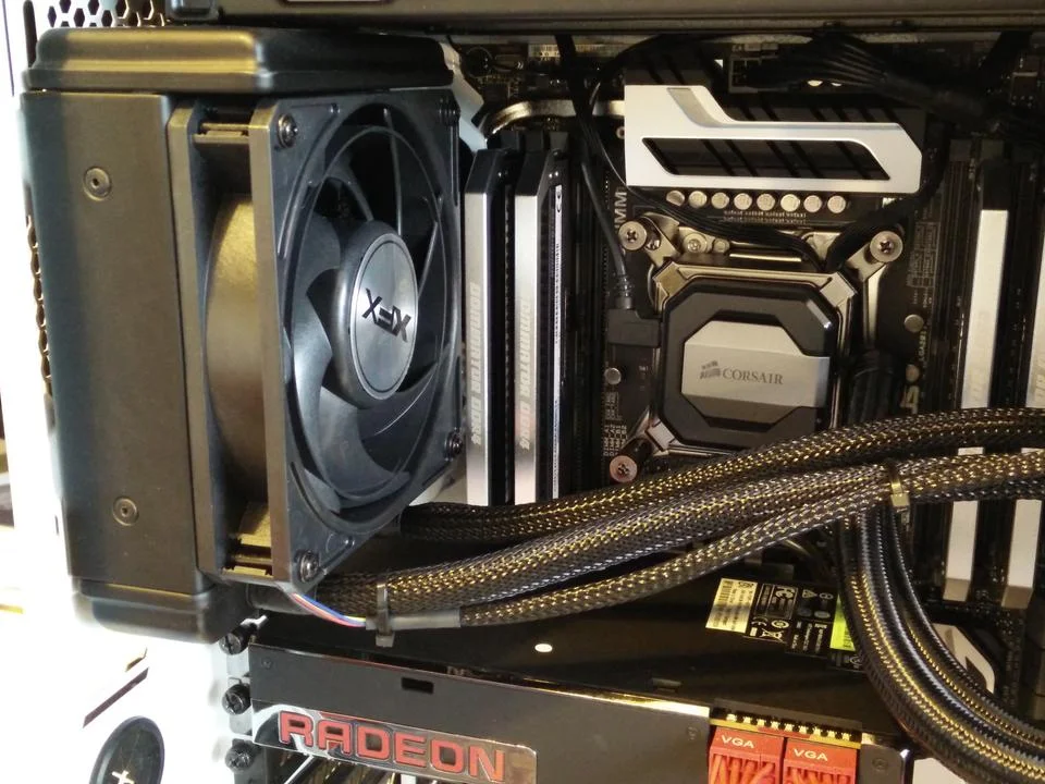

I currently barely have clearance with my Fury X.

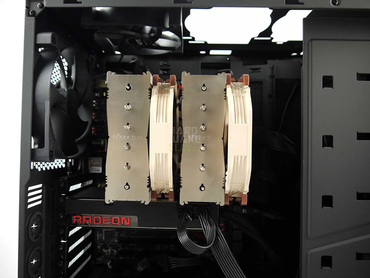

My main issue with large air coolers is the access to other parts. The Noctua NH d15 on my motherboard means it'll be impossible to remove my GPU without first removing the cooler. A massive pain to be sure, and the better AIO coolers like the EK 240 are extremely thick, making installation a hassle in most chassis.

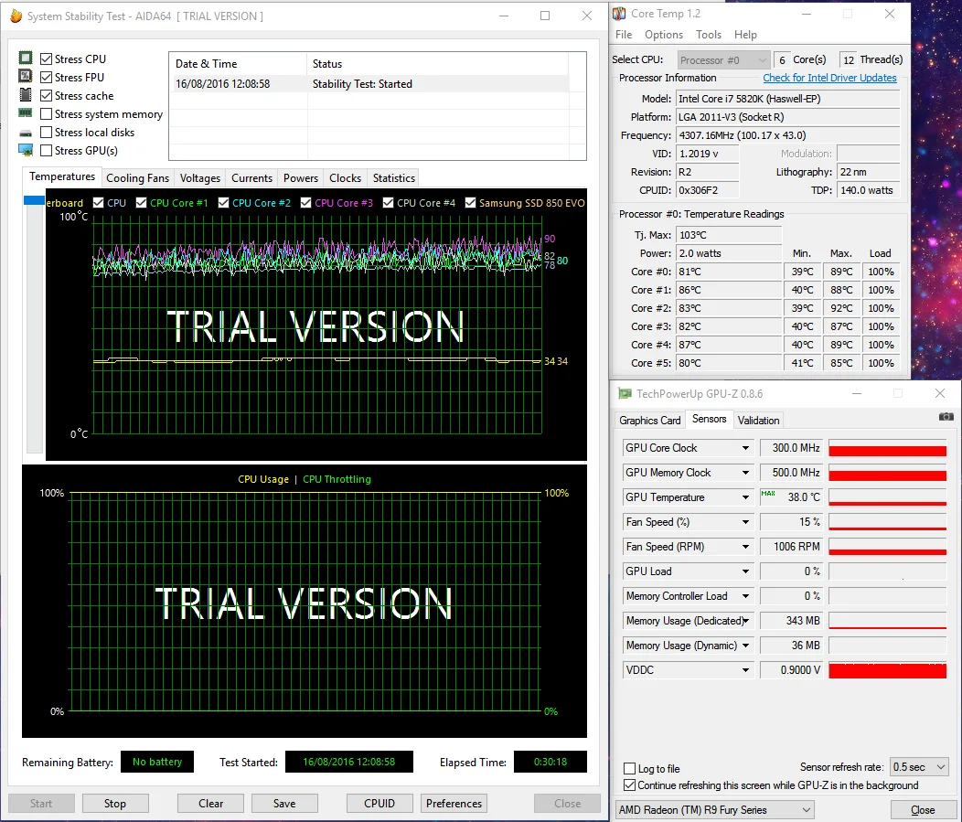

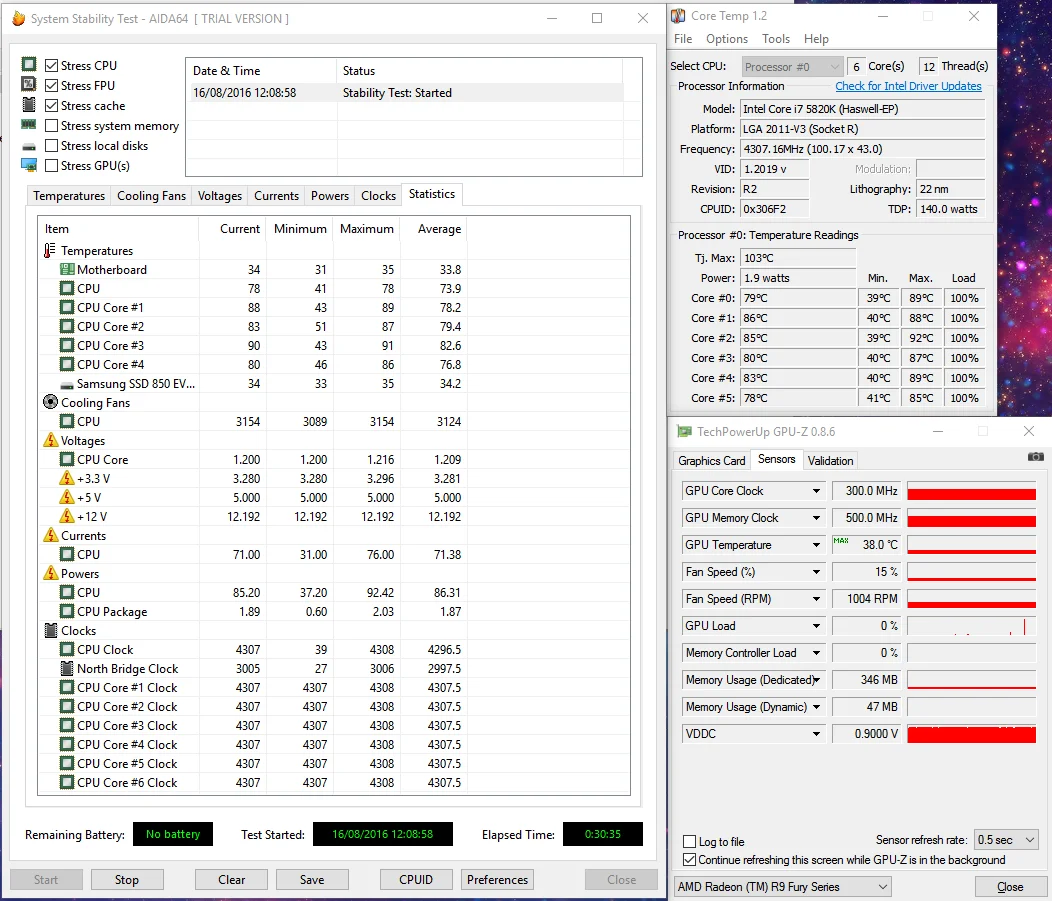

The system is stable at 4.3Ghz at 1.2V so far, and I only ran Aida64 for 30 minutes to look at temps. Averages look meh, and those max peaks are terrible. Even my Fury X was getting close to 40 degrees while idle.
Taking off the front panel and dust filter for the h440 didn't help either.
During the entire test I could hear that whir from the pump. It doesn't look like it can push enough fluid anymore, despite running at ~3150RPM.
10 minutes after the AIDA64 test I'm now idling at max of 49 according to Core Temp and AIDA64; and I can still hear the pump.
Aida64 Stability test images

The Fury X rad+fan is 65m. If you scroll up to my current set up you can see the H110 just barely fits with it as well.
