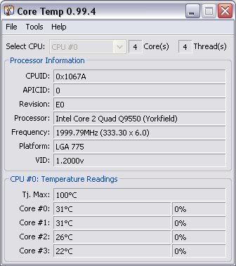

Youd probably be better with a high end air cooler than that kit. This is my q9550 cooled by a thermalright ultra and 2 fans.
