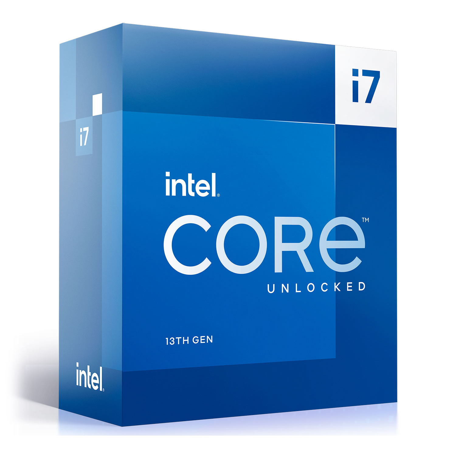

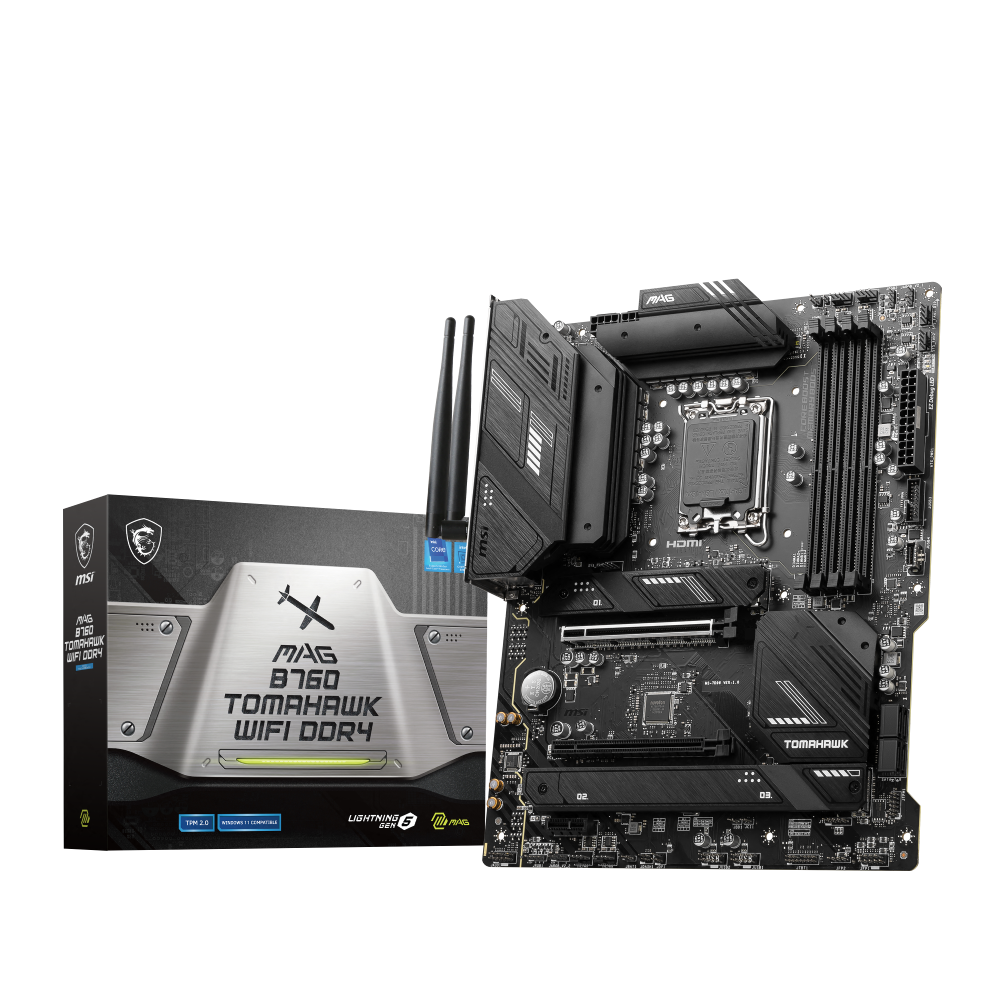

Intel 13th gen has the advantage of being able to re-use DDR4, so if you're on a tight budget it might help you get a better CPU than you could otherwise afford (e.g. i7-13700F, midrange B760 board, with existing DDR4). My opinion on the 13600K and 13700F is that if you don't care about overclocking, then buy the 13700F or non-K, since I'd prefer to have the 8 P-Cores.

At the second resolution your current graphics card will probably be at the max, so for now it doesn't matter, but if you go for something like a 4070 Ti or 7900 XT, then 1440p does have the potential to bottleneck, so I think you're looking at the right CPUs and any of the ones you suggested would be fine really. If you wanted a cpu upgrade in 4-5 years, or gpu upgrade in 2-3 years (unlikely to be value for money in this market, but anyway), then I'd go for AM5 so that you'll have options. If you're getting something more modest like a 6800 non-XT, then my opinion would be that the Intel system will last just fine and you'll need to discard it in 4-5 years rather than get a CPU upgrade, because there won't be anything that offers enough performance.
I'd suggest similar builds to mickyflinn, but I'm more inclined toward non-K/non-X CPUs:
Intel Core i7-13700F (Raptor Lake) Socket LGA1700 Processor - Retail - £359.99
Gigabyte B760 GAMING X AX (LGA 1700) DDR5 ATX Motherboard - £199.99
Kingston FURY Beast 32GB (2x16GB) DDR5 PC5-48000C40 6000MHz Dual Channel Kit - £149.99
Grand Total: £717.96 (including delivery charge, £7.99)

I assume you're going to need a cooler too? The non-X stock cooler (Wraith Prism) isn't actually that bad, it can handle gaming, but I'd definitely want something better for the i7-13700F.
