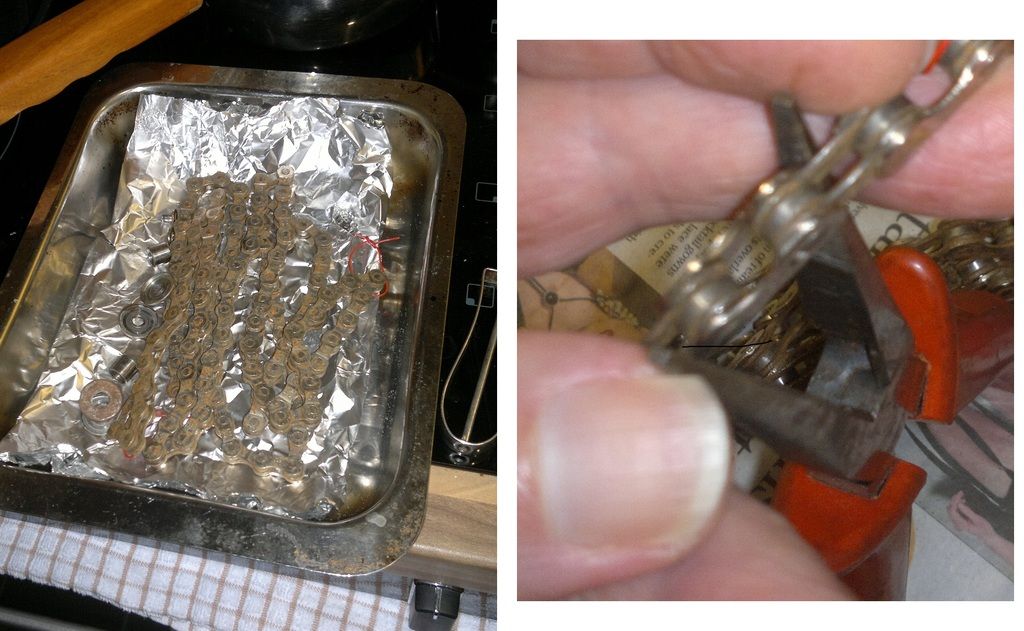

strategy that worked, to break it apart, was long nosed pliers across the powerlink (do not think I torqued the plates)
Left was the freshly baked chain after degreaser /toothbrush scrub/boil wash (toothbrushes are dam good - need to buy some cheap ones in bulk)
Strangely the outer side of the chain was corrosion free, but the inner/wheel side had face corrosion, have not seen that before ?
chain_break_zps5zxq960c.jpg~original
