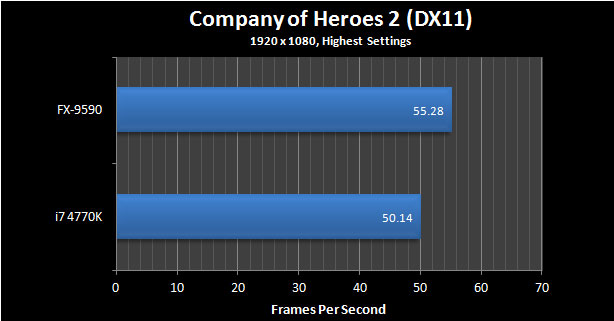

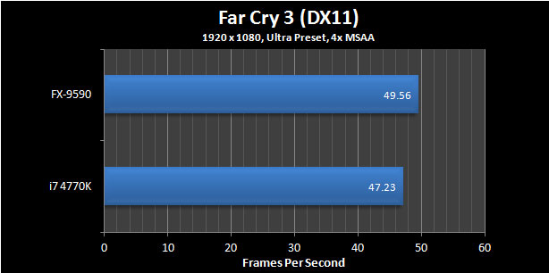

Anyway i agree, but the point is this cpu is not that bad when multi threaded games are thrown into the mix. Infact when this occurs its a capable cpu. For single threaded stuff yeah its not going to be as good but im guessing with his setup he won't be playing many old games that only use 1 thread.

Generally speaking, you'll be fine. In a few circumstances you might bottleneck your gpu's a small amount in single/dual threaded games, but it is nothing too worry about. In games that make use of 4 or more threads your performance will be nearly equal to, or slightly slower than intel's current flagship i7. I'd expect things to get better once the consoles come out and 8 core threaded games become the norm.

It's a bit blanket to say single threaded and multi threaded, because that's not technically right.
It needs to be heavily threaded for the FX8350 to catch up (Or so GPU limited that lower threaded games aren't hit)
Because something that uses 4 threads is multi-threaded, but the FX8's not going to be better as its core for core is much lower.
Isn't that with a single GPU? If he's not got enough in the tank to feed 1 GPU, he's not going to have enough to feed 2.
That's forgetting that the 4770K is stock, has about 1GHZ left in the tank, and the FX95 is pretty much at its max.
His performance won't always be equal even if 4 cores are used, and why suggest the i7 in that? Given you know, for the i7 to do anything over an i5 it needs to be using more than 4 threads.
