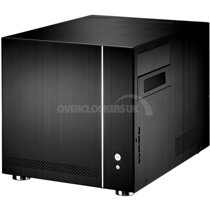

Lian Li PC-V351 (micro-ATX):
Dimensions (WxHxD) 279mm x 262mm x 373mm
