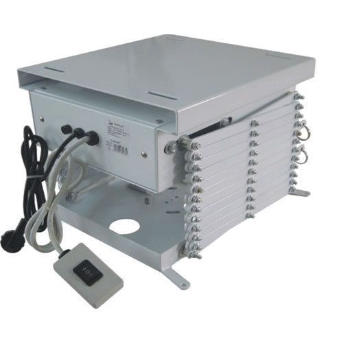

Cutting a chunk out of joists to allow projector lift to fit?

Would it be OK to cut a through my joists to allow a projector lift to be installed in my ceiling?
