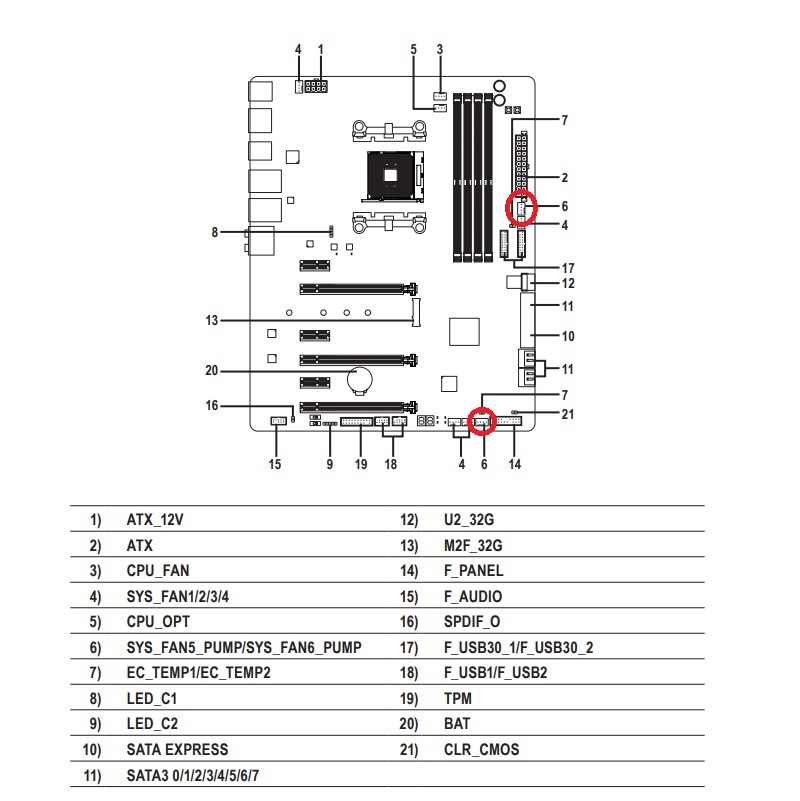

According to your manual these are the only headers that support the pump speed/adjustment
If you haven't already i would give them a try first and see what happens. Failing that, check the wiring from the pump to the plug and see if its been crimped anywhere.. they aren't the thickest of wires nor the strongest.
Ek suggest that you plug the pump into the cpu header and thats how its been for 8 months or so and worked fine up until now, I have tried all other headers on the board to rule out a problematic mobo header but they all behave the same with the pump connected (no rpm readout)...
