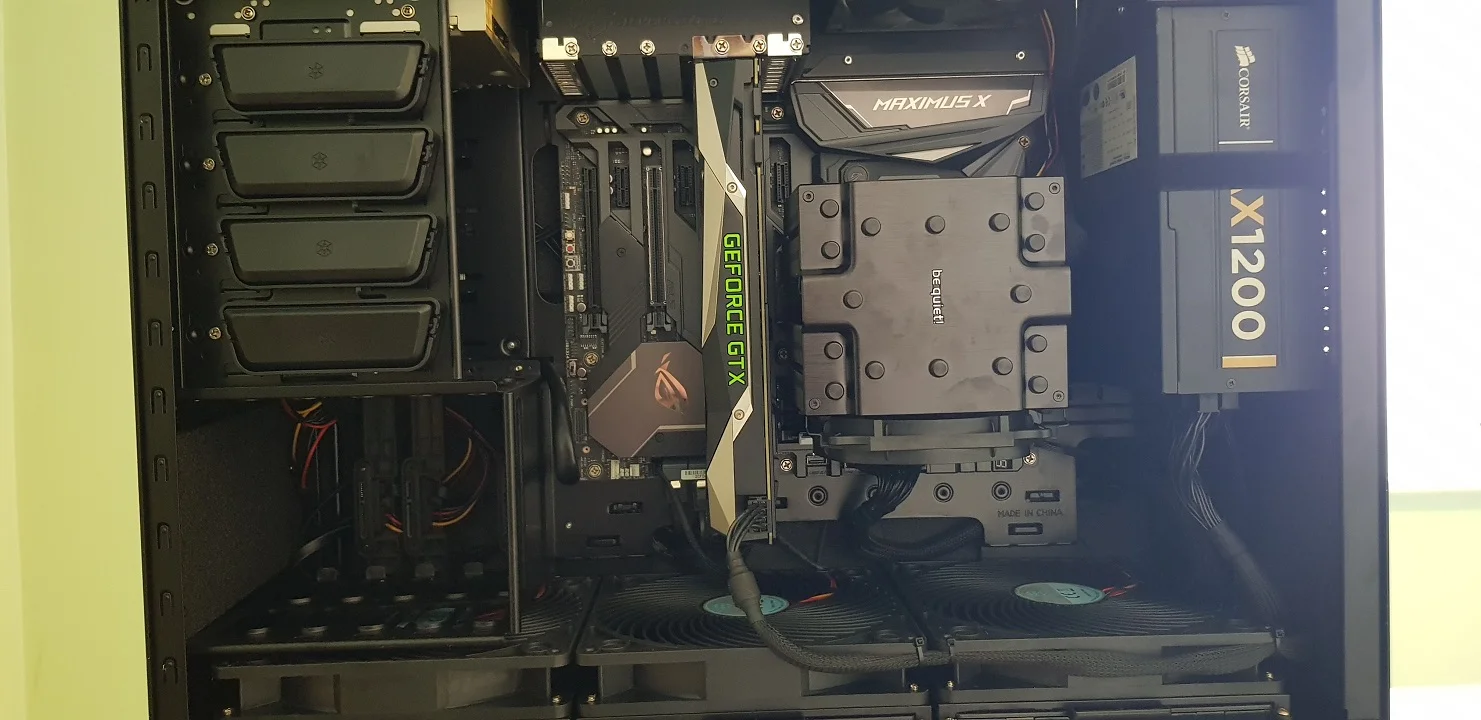

I got one, but it being used in my case so am not sure if there a way I could measure it to the last mm
