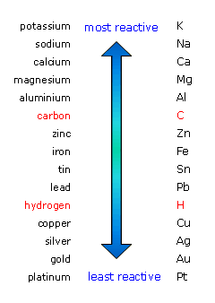

Copper is pretty unreactive stuff tbh.
Without causing offense you need to go back to school. Theres only 3 metals more reactive than copper and those are the "precious" metals
Deionized will fine, so will purified.

three metals more unreactive ,,,,dont you mean?
potassium for example + water is very dangerous

Observation fail. thought I remembered electrical conductivity correlating with reactivity but go it the wrong way round, either way deionized will be fine.
