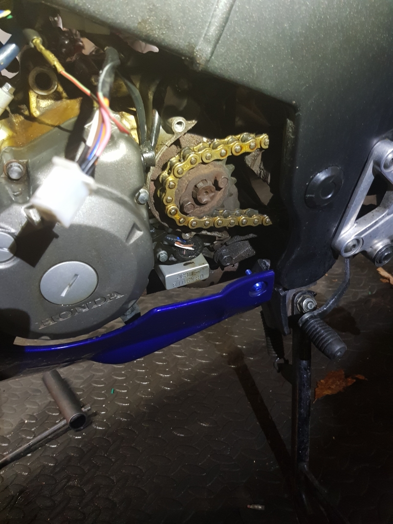

See the thing with wires on it below the front sprocket?
It's a push fit little sensor that may or may not have an arm or bolt holding it in place.
I will see if I can find a pic of it on my 110 monkey engine. It's likely to be very similar.
*Edit*
Looks like it may be above the sprocket on your engine.
https://www.ebay.co.uk/i/1637546359...S-lGJM4FZEOlbpbR-A4dFyy146zVD_HAaAnIpEALw_wcB
You can see it here above the front sprocket, assuming yours is similar :)
