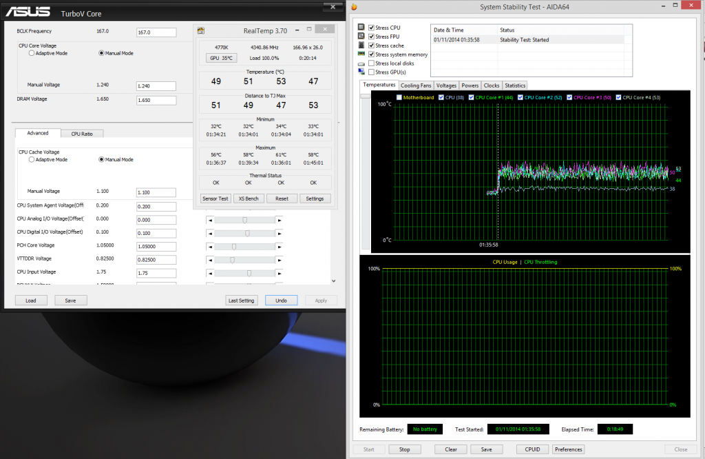

Hi all, usually just a reader and don't post much but today after delidding my 4770k wanted to share my experience with you all.
Generally my 4770k runs hot while gaming and even hotter when using IDEs related to programming & database. I planned to buy 4790K then had a thought why not delid (just wanted to give it a try) if I screw up will buy a new one as planned, if not some money saved.
I run a custom H2O loop and I've managed to overclock my 4770k to [email protected]. In Prime95 I usually hit 95+ degrees in all cores within few minutes. I have tried changing my TIM with no real luck.
Unfortunately I don't have any screenshots before delidding but trust me it used to run hot.
Here some after delidding. Max I have hit is 70 degrees in prime 95 (ran only for 30 minutes) considering it used to hit 95+ in minutes this is really a good outcome. Overall I'm pleased with the results.

I used razor method. I don't know how it happened but I managed to delid in 15 mins.
Started around corners and then onto sides. Overall it took around 100 minutes for whole process.
CLP - Between die & IHS
MX4 - Between IHS & Copper block
