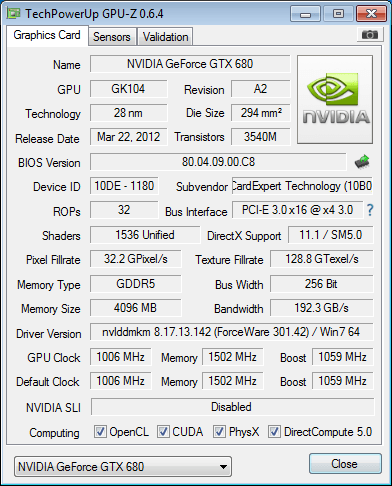

Ok so i just took a screen shot of GPU-Z whilst running furmark and the bus interface seems to show that it's running at only x4 instead of x16 if i am reading that correctly. I know it should change, as i've compared other screen shots that say @ x16 instead of @ x 4.

What do you think about the bus interface speeds? is this down to a driver issue or should i try running at pci-e 2.0 instead, would i lose performance over pci-e 3.0?

Yeah thanks guys, i've changed the pci-e slot to 2.0 and it's running BF3 fine on ultra settings now.
I guess maybe an updated driver is needed for full compatability.

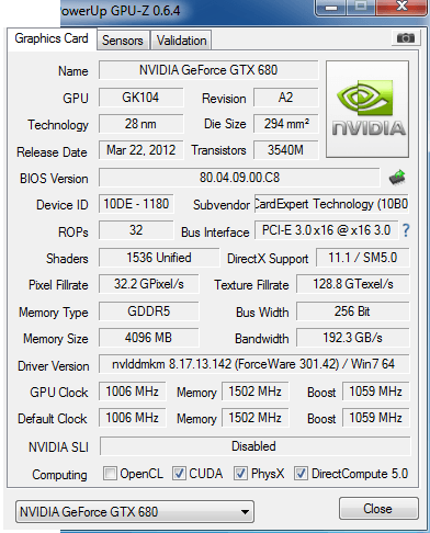

I've changed my mobo to the one in my sig, much better board.
Anyway, the x16 pci-e3.0 is now resolved, if you compare the bus interface above and this one i just did.
