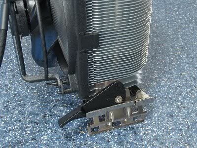

As the title suggests, I did not get a retention bracket with my arctic cooling 64 pro heatsink, Am I supposed to?
I have the AMD dual core 4200 socket AM2.
My motherboard's retention bracket is of the wrong type, as you can see why from these images.
These are the clip orientation on the Arctic Cooler.

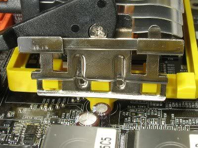

This is my motherboard's bracket, and it's screwed on by 4 screws on all sides

Oh and incase you're wondering, I've already attached the fan, and it's very unstable, as I need all 3 clips attached, not just the middle one.

The freezer 64 works fine on socket AM2. I had one with an AM2 chip and used just the middle lug and it was fine.
Ok well.... the retention clip on the bracket broke, because there's only one of them on each side:( Now I'm in a real mess. my motherboard is the MSI M2N4
Does anyone know of any fan that has that bracket? I know that the bracket is a socket 939 type, but it MUST be of the type with 4 screws.
