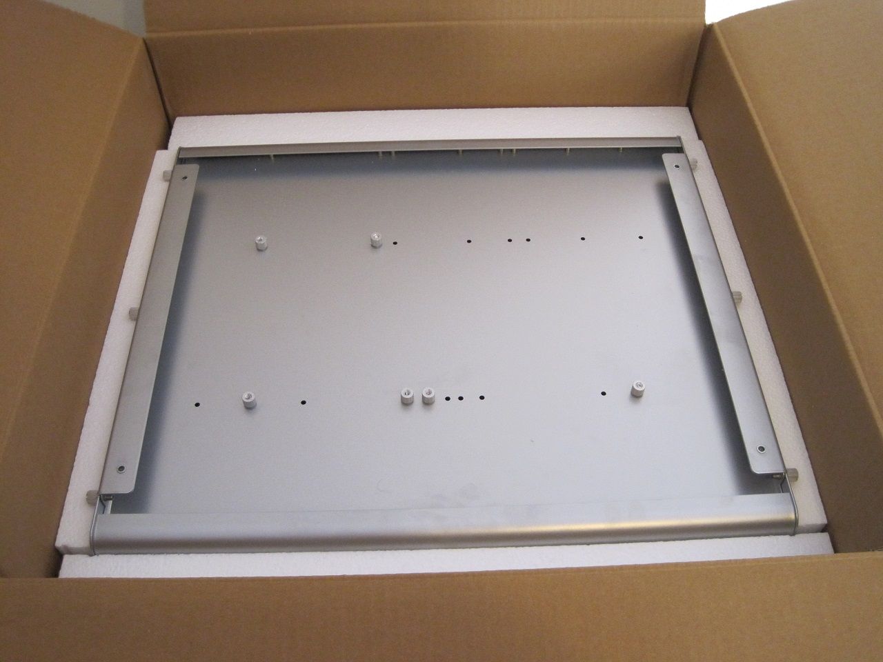

packaging.

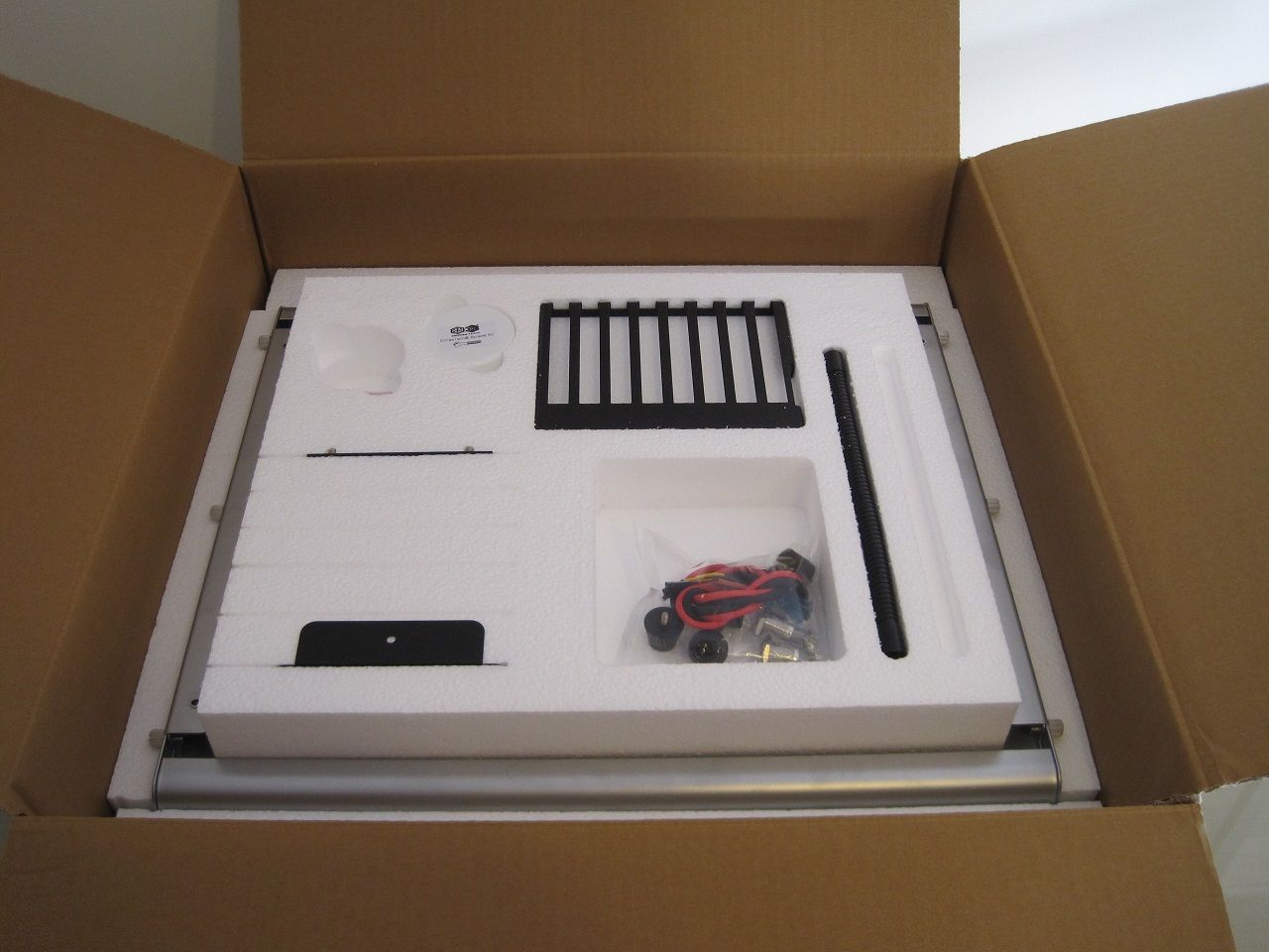

The Easy V3 arrived in a large cardboard box with the most annoying packing foam ever, it is the nasty stuff that screeches and really gets into your ear drums, hate it.
The main body of the test bench is pre-assembled, good thing really as there are no instructions supplied with this.

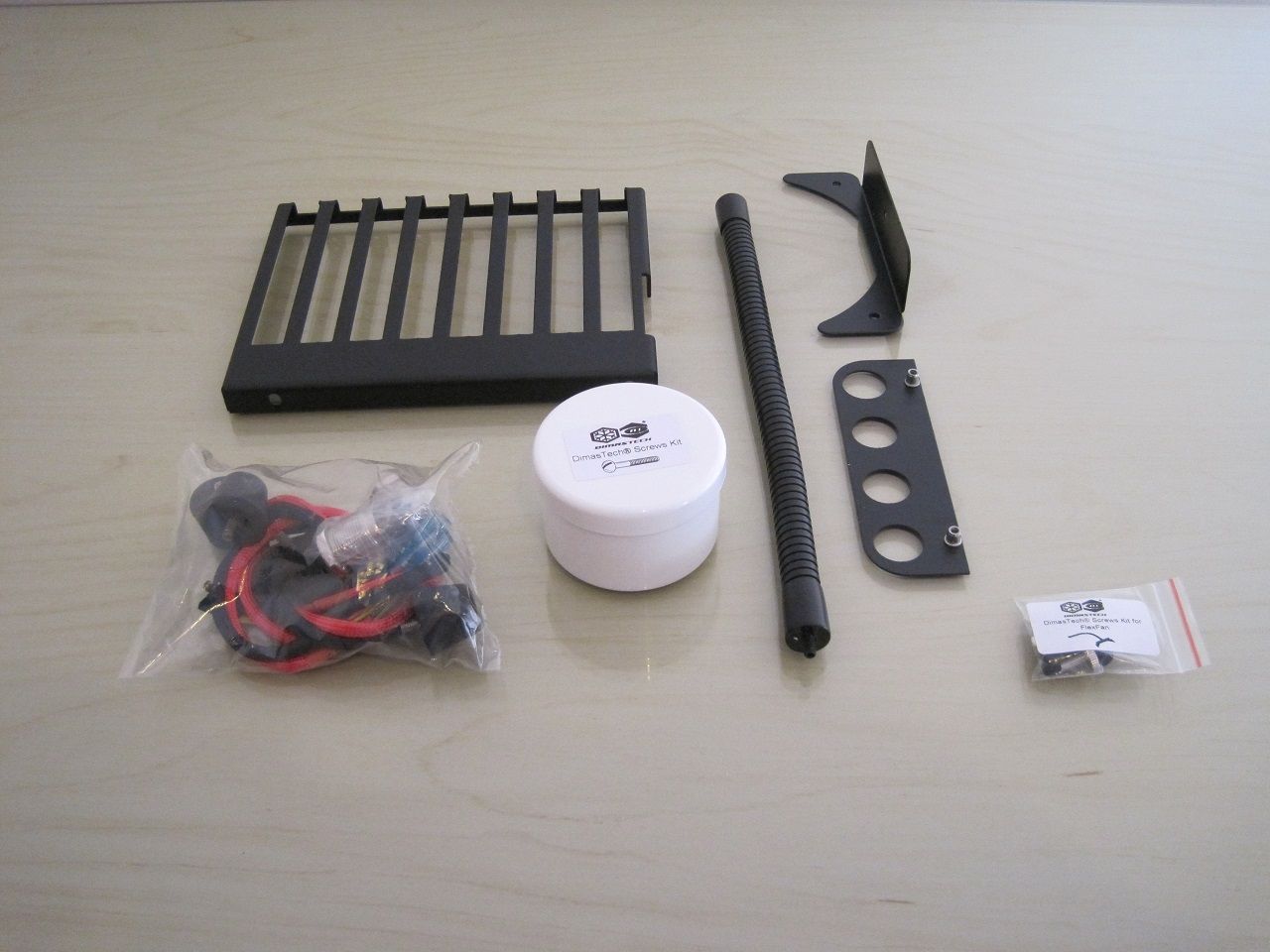

Accessories.
This is all that comes within the box,

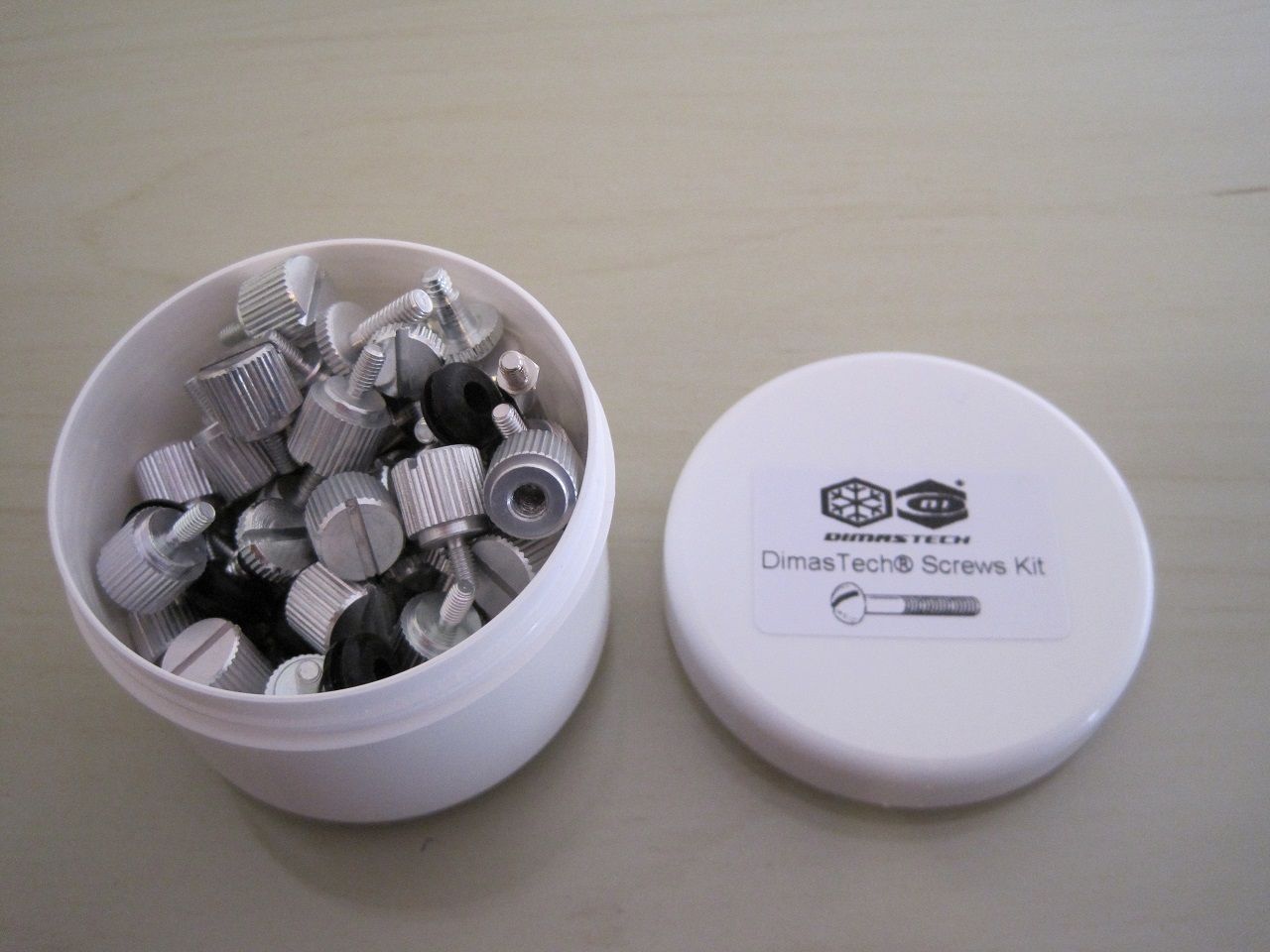

• Pot of assorted screws.

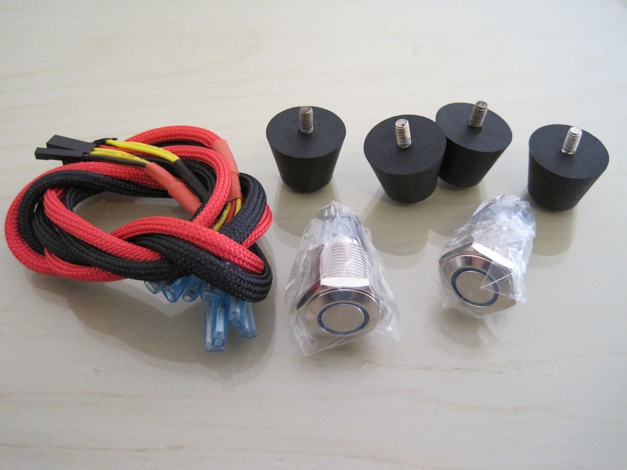

• Four rubber feet.
• Two anti-vandal switches with two braided cables.
• A flexible arm with a 120mm fan mount.
• A plate with four holes 17mm holes for water cooling.
The screws supplied are of a sufficient amount and assortment for my uses.
The braided cables and switches are of a very nice quality.

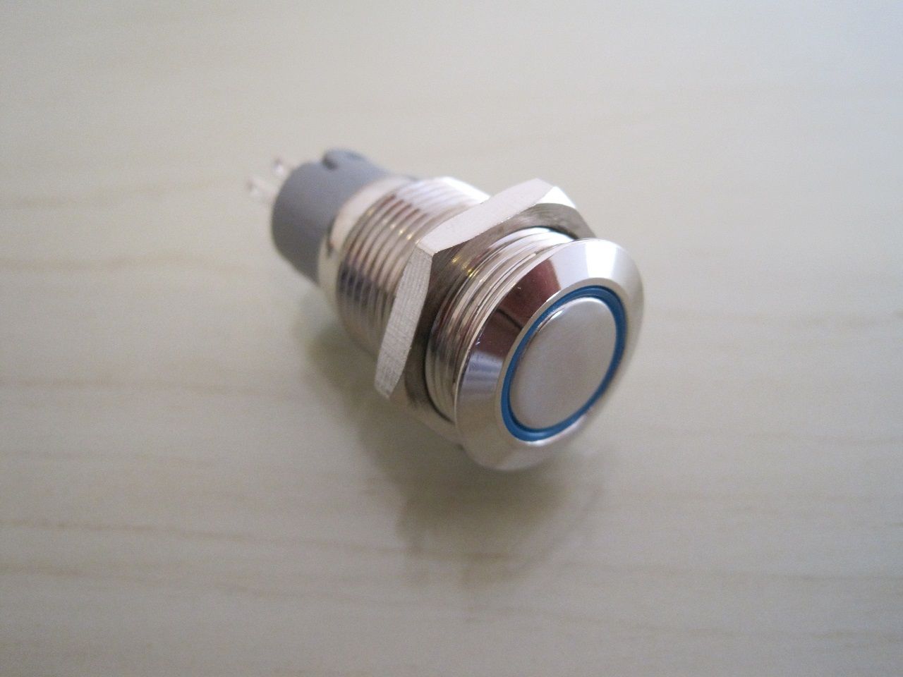

There are five terminals on the rear of the switches labelled as,
NO, NC, C, +, -
As there are no instructions supplied with this test bench a person with no knowledge of what they mean may not get the switches to work correctly first time, the ± are obviously for the ring LED around each switch and wont pose a problem for anyone.

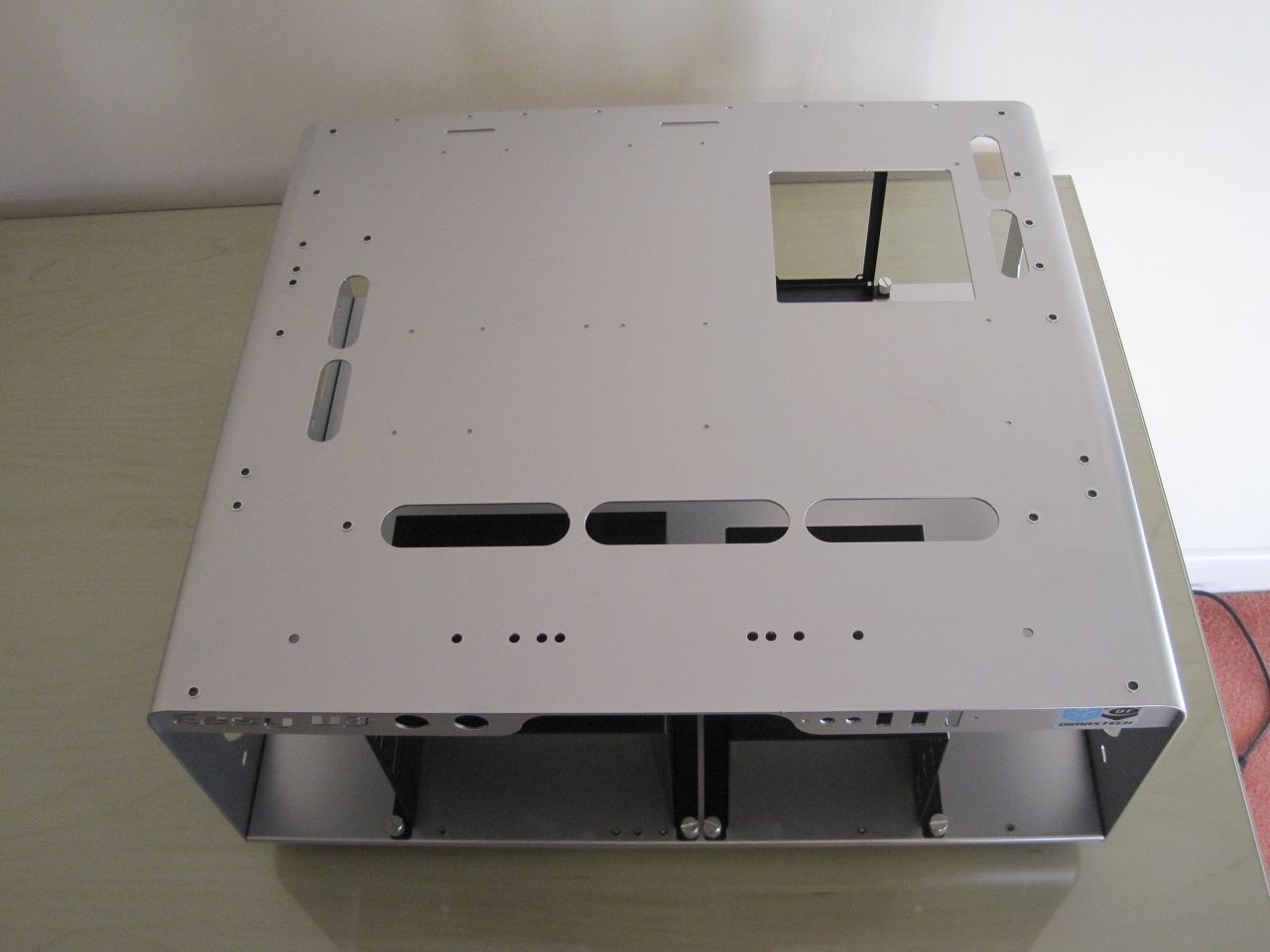

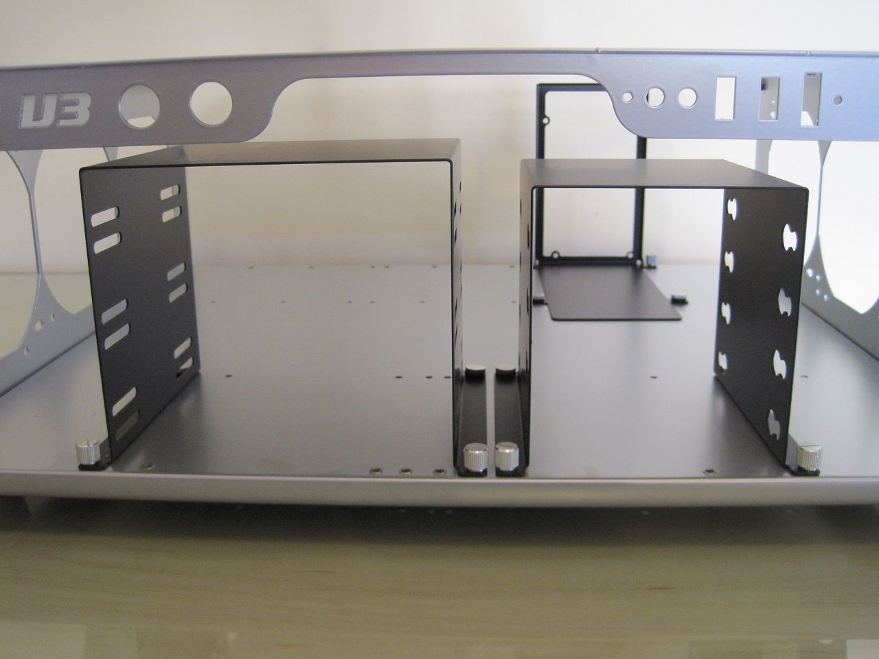

The bench.

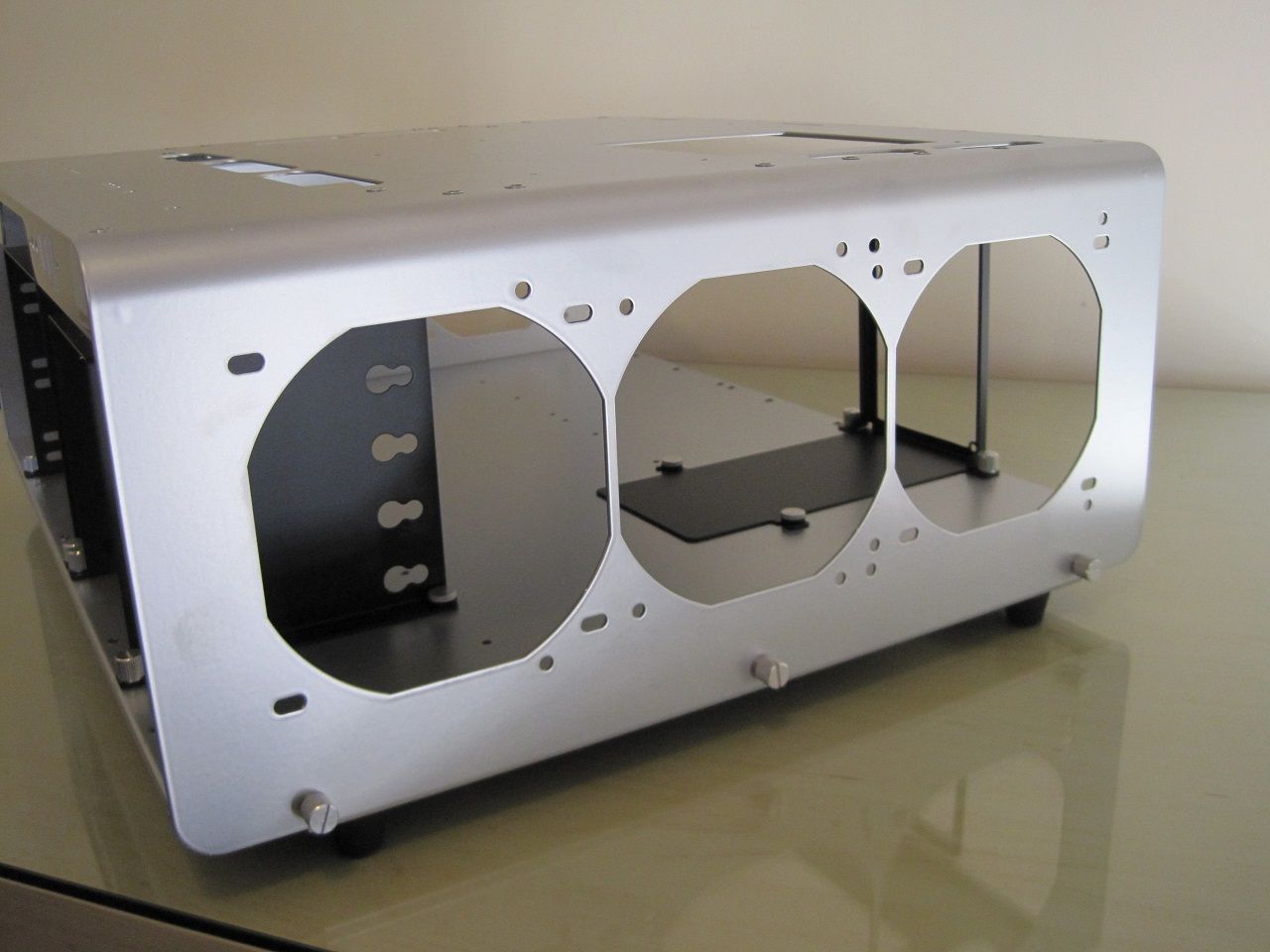

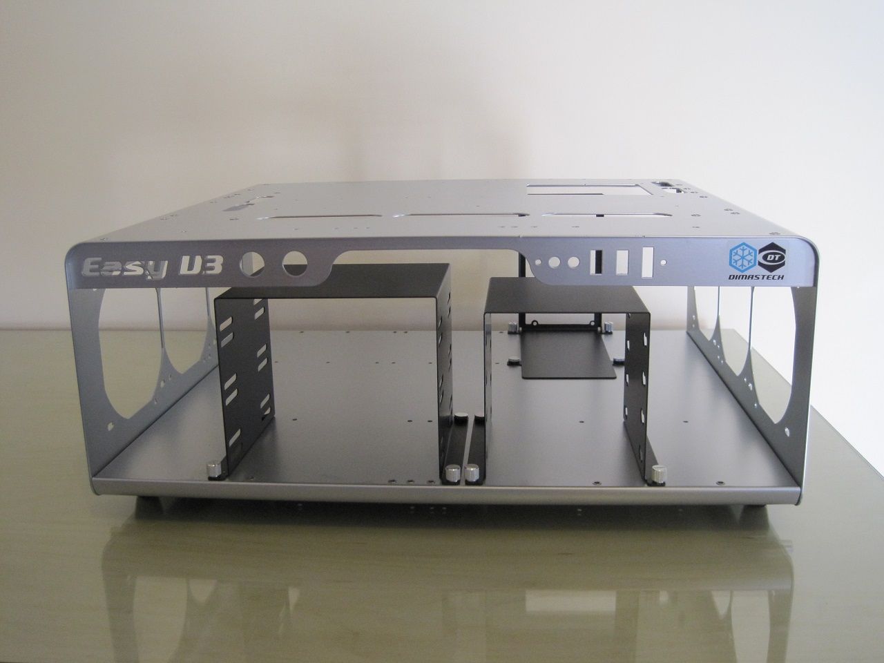

That is how it comes assembled out of the box, the drive cages and PSU mount are already fitted.
There are plenty of captive nuts fitted in the base for you to be able to re-position the cages and PSU mount.
Both sides can fit triple 120mm radiator or a dual 140mm, there are elongated slots for differing 120mm spacing.

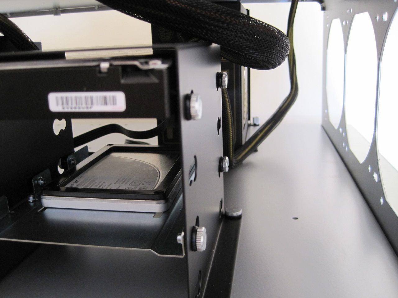

3.5" drives are secured with rubber grommets to reduce vibration.
Unfortunately no way of fitting a 2.5" drive is supplied, so if you don't have an adapter plate then you need to get one or use a bungie mod or velcro.

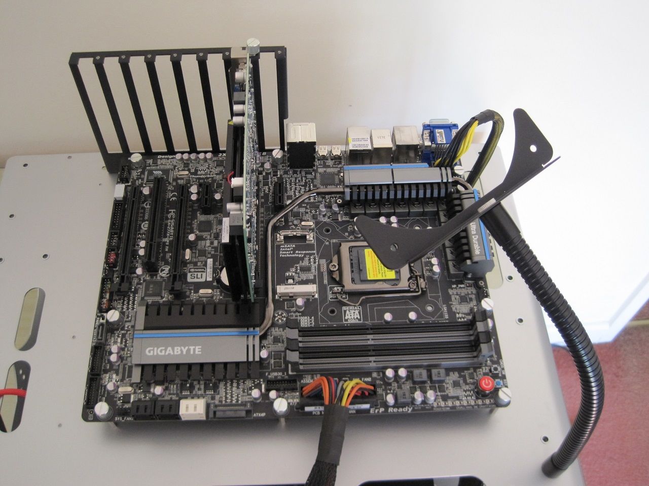

No fan is supplied for the flexi arm mount.

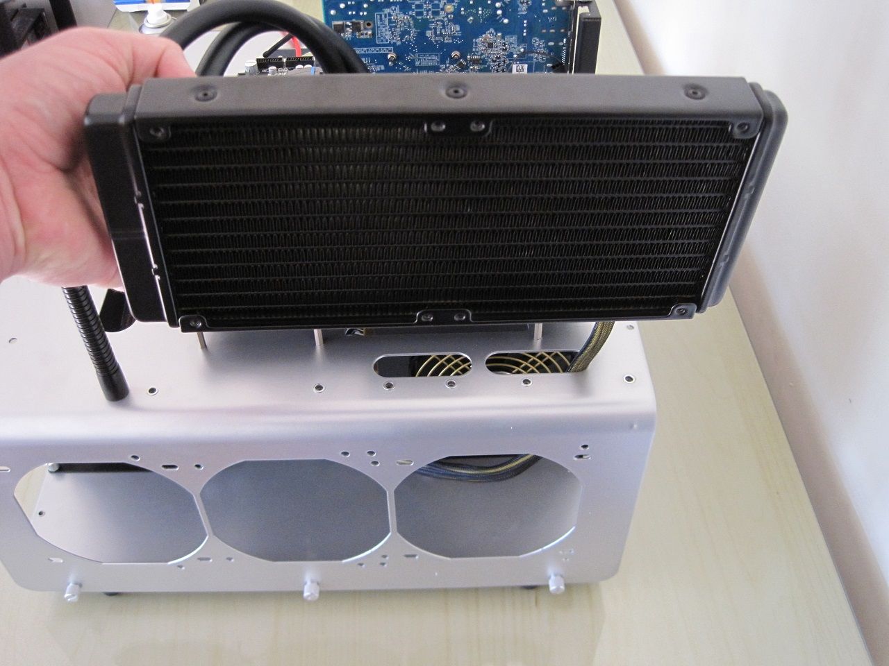

Would have been nice if a plate that held a closed loop water cooler in this sort of position was included, it can not be mounted in the test benches normal radiator mount position as the tubes on these closed loop water coolers are too short.

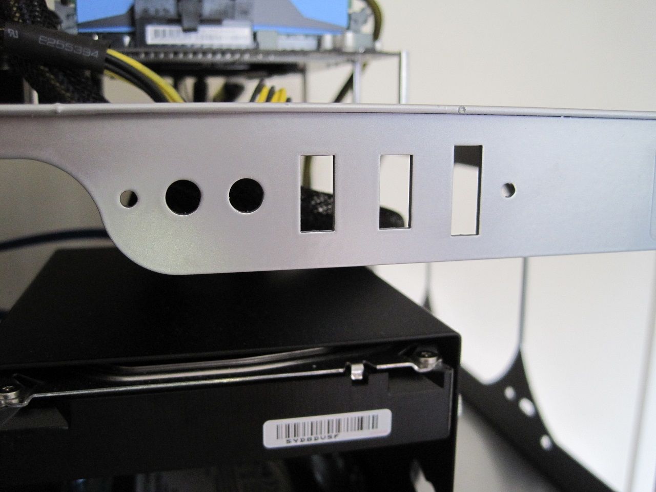

This is where an optional I/O Panel can be bought and mounted.

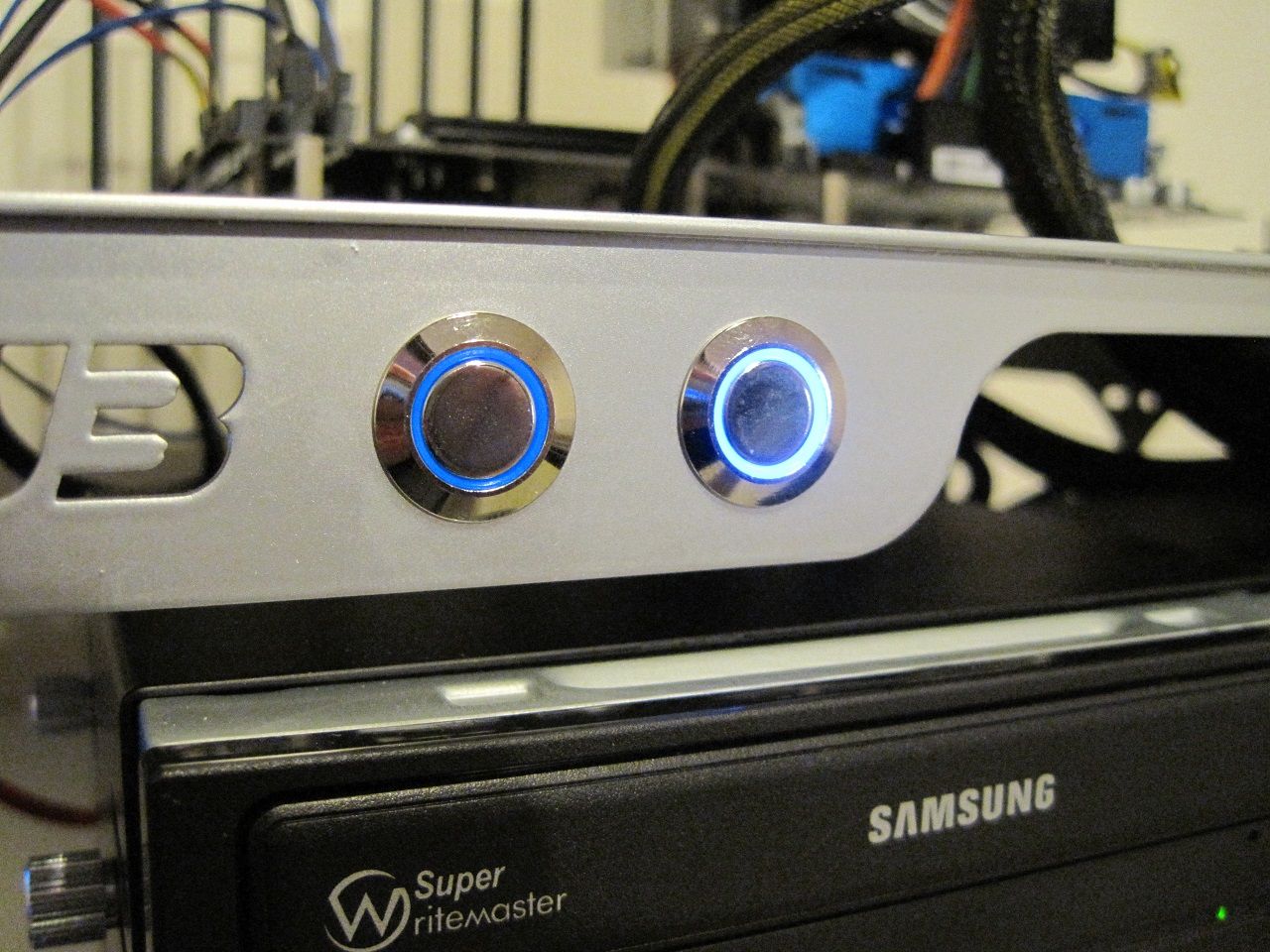

This shows how the switch LED illuminate.

As for the I/O shield, it wasn't a deal breaker for me, I'm not sure if many or even any bench tables support them.

I have noticed another flaw with it, when trying to fit two different SSD's that use a smaller adapter plate they cant be screwed in and secured at both ends, I've had to rig some cable ties up to hold them at one end.
[/URL]
Certainly not SSD friendly, which you'd think it should be given the market its aimed at, those that need fast boot times for cycling overclocks.

I thought the purpose of the I/O shield is to keep static discharge and dust out, EMI and airflow in. If that's the case then there's not much point including one with a test bench.

Correct, the I/O panel is an optional extra (OcUk are getting stock) the flexi arm is useful to direct air at the boards VRM area etc, but should have included a fan really.
