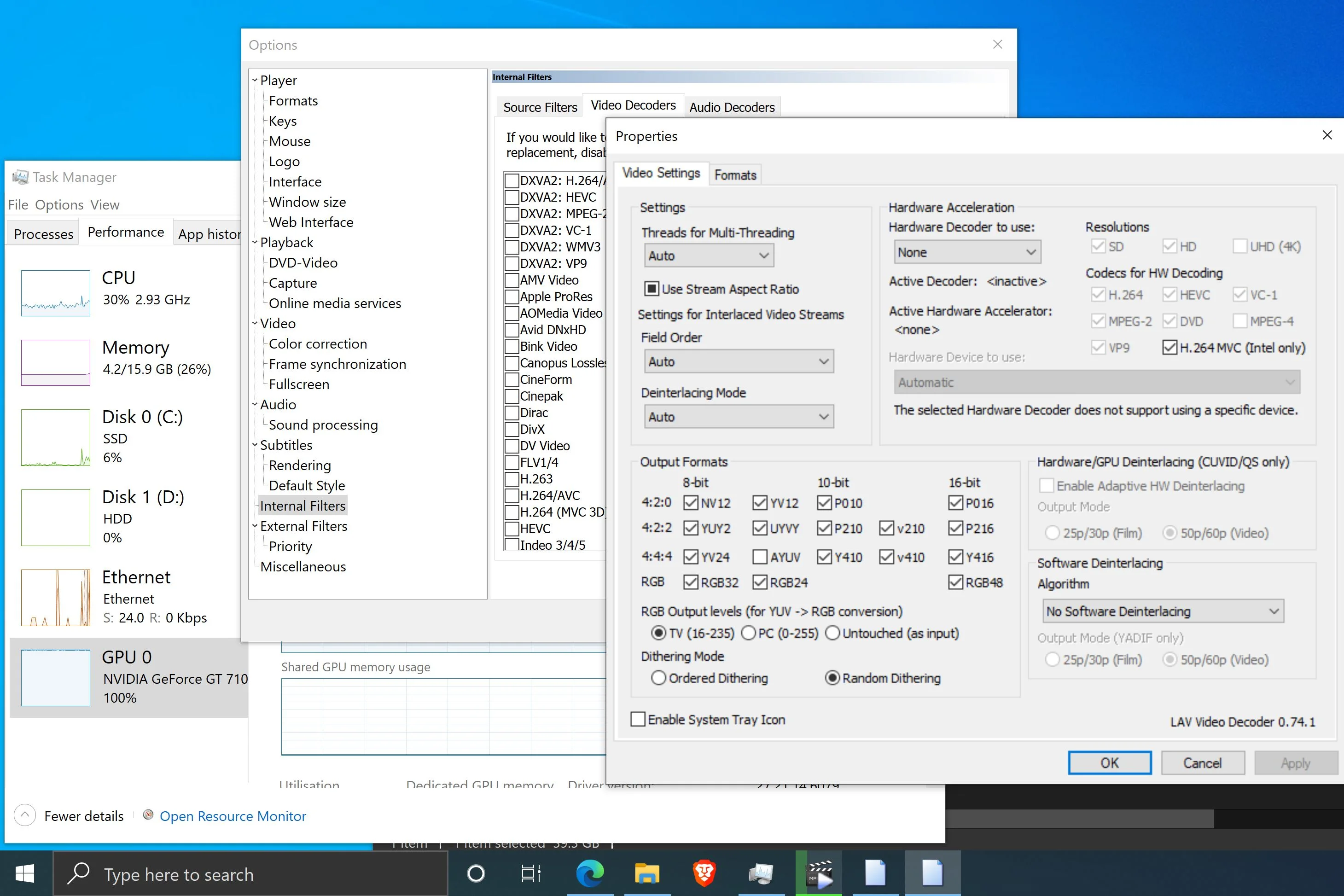

I apricate the continued follow-up from people.
I got him to send me the screen shot below.
  • All MPC internal filters disabled
  • LAV splitter, LAV splitter source, LAV video decoder and LAV audio decoder added as external filters
  • Hardware Acceleration decoder set to None
Yet as you can see the GT 710 he is using for the HDMI port is maxxed out!

What does the external filters look like? It should be set like this, all set to preferred: https://i.imgur.com/THLI3wS.png
I just tested it myself, setting hardware acceleration to none does stop the GPU video decoder from doing nothing, but MPC itself is still using the GPU to render the video. I couldn't work out how to switch to software rendering.
Is it possible to enable the IGP in the BIOS, and in LAV, set the hardware device to the Intel IGP? Not sure if that will significantly help but it might be worth trying.
Also, you might want to uncheck H.264 MVC. RGB Output could also be changed to 0-255 or untouched.
