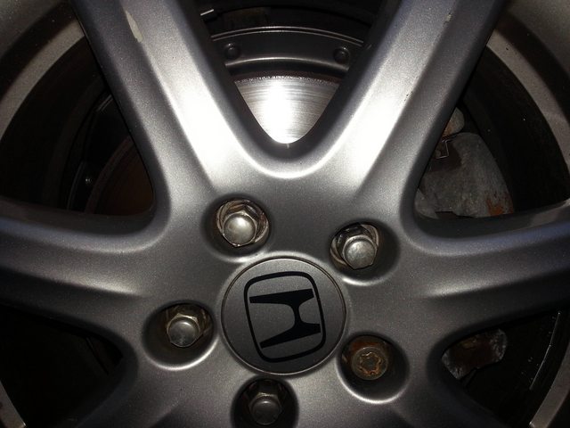

you might want to check that you have a locking wheel nut key that is intact for when you really need it and that that locking wheel nut is not stuck. Looks like the key has sheard off
Good eyes! However, it's just the angle of the camera or flash or something giving that impression. Thankfully, the key and nuts are all OK.
