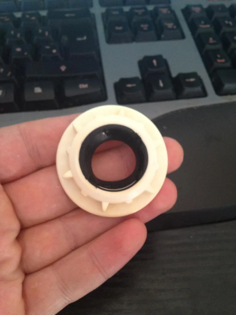

So it seemed to sort itself now, but another thing is now broken. Where the top shelf meets the back for the water supply, the seal is all knackered. In addition to this, it's generally not washing properly, probably as it's old, clogged up etc.
Should I just go out and get another one/ I know Miele are the ones to go for but I've seen some good deals on Bosch dishwashers, worth a punt?
This is the part I need. It sits at the top where the water comes up to the shelf. The seal is split so the top shelf cleaning is useless. Persevere with this or get another? Seen a nice Bosch for cheap local to me.
You seem to be having lots of problems with the one you have, you could throw money at it and then then it dies next week.
You can buy a Bosch/Neff/Siemens and get 2 years warranty.
Then I'd just buy another second hand? My current Hotpoint cost £45 around 30 months go and only started going wrong around 3 months ago or so. I think it's safe to say that I've had my monies worth. A new Bosch is well in excess of £350 from a quick search.
