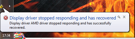

Display Driver has stopped responding!!!

http://i1118.photobucket.com/albums/k610/cbrooksc/Untitled-2.png?t=1302630538
how do i go about stopping this?? this has happened 3 times so far after the second time I downloaded msi afterburner and now it's just happened again!! how can I fix this?? it's really starting to bug me, and i'm not really running anything to complex just watching dream hack
