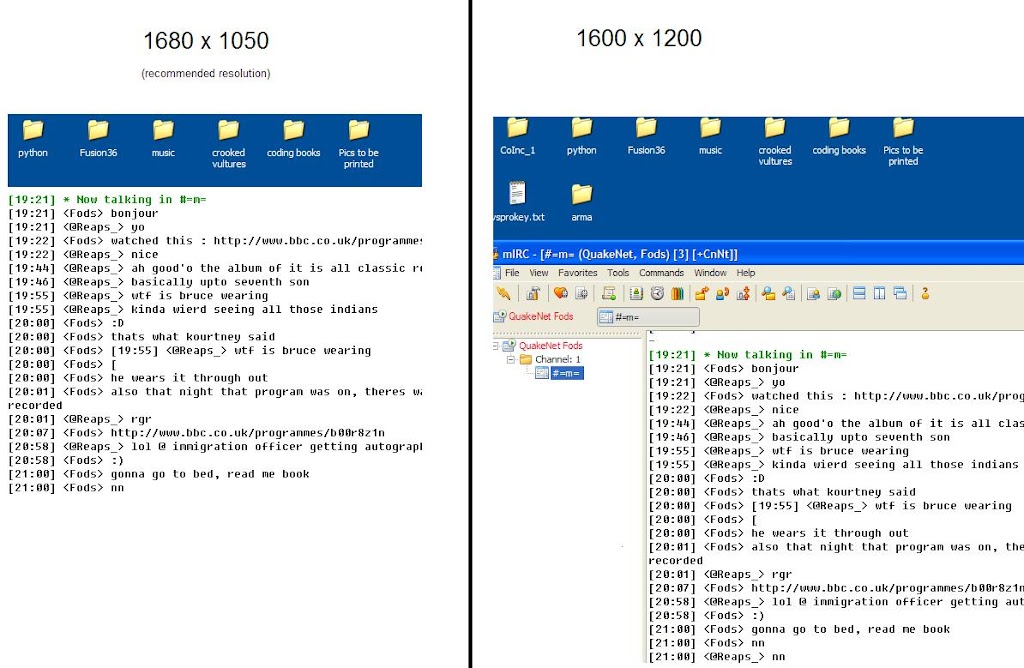

i have 2 monitors (Dual monitors) that i've had running on a Radeon 4800 HD and its been fine for a while. but the other day i was playing around with the settings and ended up breaking the font.
as you can see the font is broken (squashed).

As for the fonts, unless it's incredably subtle I can't see it.
Is it obviouse on your screen?
Try taking a picture with a camera.
If the screen shots aren't showing the results, I suspect it's your monitor.
Check to see some sort of aspect ratio/upscaling isn't switched on on either the monitor or the graphics card. Make sure it's 1:1.
yea its true about the images, they dont seem to show the effect on the font from a screenshot.
i see if i can find something with regards to aspect ratio
The native resolution of your monitor is 1680x1050. By increasing this to 1680x1200 you've effectively 'squashed' the image. The pixels are a fixed size (hence native resolution) and there are a fixed number of them - set the resolution to anything else and you WILL get distortion.
Why don't you reset the resolution to 1680x1050? Or is this your problem? :confused:
yea if i set it to the native resolution (1680x1050) it looks worst (so i leave it on 1600 x 1200 as its better but not good :/)
