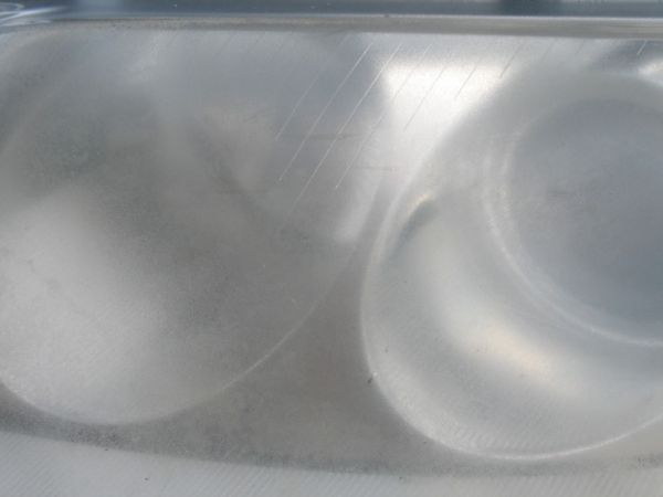

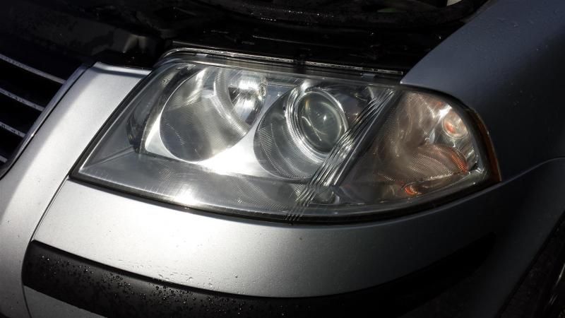

Obviously not aggressive enough sandpaper then. Mine came up a treat.
From this.
To this.
Maybe 45 mins per side.
