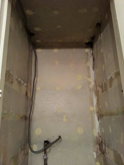

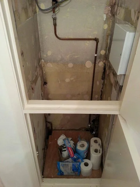

Sorry for hijack (tell me to bugger off if you like) but what would you guys do with this? Was an airing cupboard but combi now fitted in kitchen so it's free space. Problem is it's part wallpaper but mostly crumbling plaster with large holes in places.
I want to use it as a cupboard for the usual stuff, bedding etc., but as you can see it needs a lot of work.
Shaz]sigh[;23485197 said:It's a cupboard so not overly important to get a quality finish I'm guessing? I'd probably half inch batten it, plasterboard, tape, feather fill it then paint. No skim needed, quite cheap and a lot faster than patching.
What as going to say the same, could just dot and dab the left side too
Whoa, thanks for the tips guys. Will bear that in mind when I come to tackle it. First job though will be to move the pipes as the one you can see is only a few mm away from the plaster.
And shaz yes you are right, an immaculate finish is not important.
You want to get a roll of scrim tape to use for the corners, will save cracks appearing later.
 Batten the back wall to the depth of the pipes, and board over them. Unless there is an actual need to move them?You want to get a roll of scrim tape to use for the corners, will save cracks appearing later.
Moving the pipe is going to be a pita if it's still feeding a shower on the other side? I'd just lose a little depth and box or baton it out at the back as Jez says.
