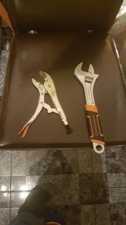

Attempted to take the stop off the end. Found it was octagonal
Nipped to B&q as I have no tools.
Success! Glad I didn't get a plumber in !
