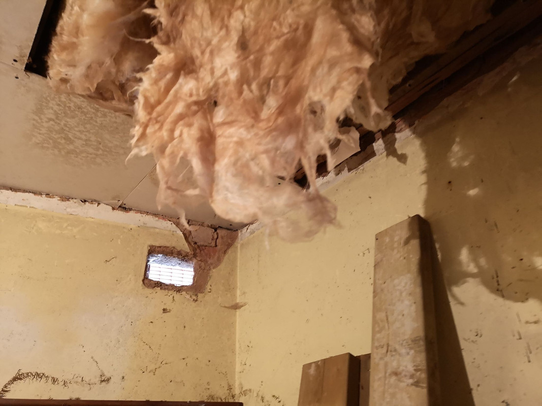

but I am currently looking at a horrendous bungalow thats up for sale with a flat roof.
As they say a picture speaks a thousand words...
The price matches the condition. The entire roof is f-ed to put it lightly. The interior walls are all plasterboard and the water has gotten in and long story short the whole place will need gutting.
