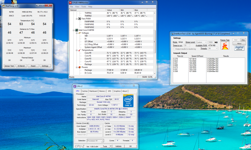

I OC'd my i5 4670k not long but but from what it seems the vcore im using is too low for the clock, however I have stress tested for 3 hours and played long (12 hour) stints on CPU heavy games like dayz.
Also my temps seem to be jumping around the place, one moment its 70c the next its in the low 50s, then it'll jump back to 70. Any idea whats causing this?
Heres some screens anyway.
Temps showing 70 here
Literally 5 seconds later showing 54
I know HWMonitor says 71c it does drop with the drops on realtemp it just seems a little more latent.
Vcore is currently 1.187 if you cant see, it would seem photobucket dithers pictures quite a lot.
Thanks
Looks fine to me... temps ain't going over 60C and vcore is less than 1.2...
i take it the cpu passed the intel burn in test...
suggestion... run the test on 10 loops with ALL RAM... will take longer, but if it passes, then you are 100% set
It's fine, max temps report in the 70's from your pics. Try running on maximum it should use all the ram and manually set the threads to 4. Stop if it goes over 85 though.
