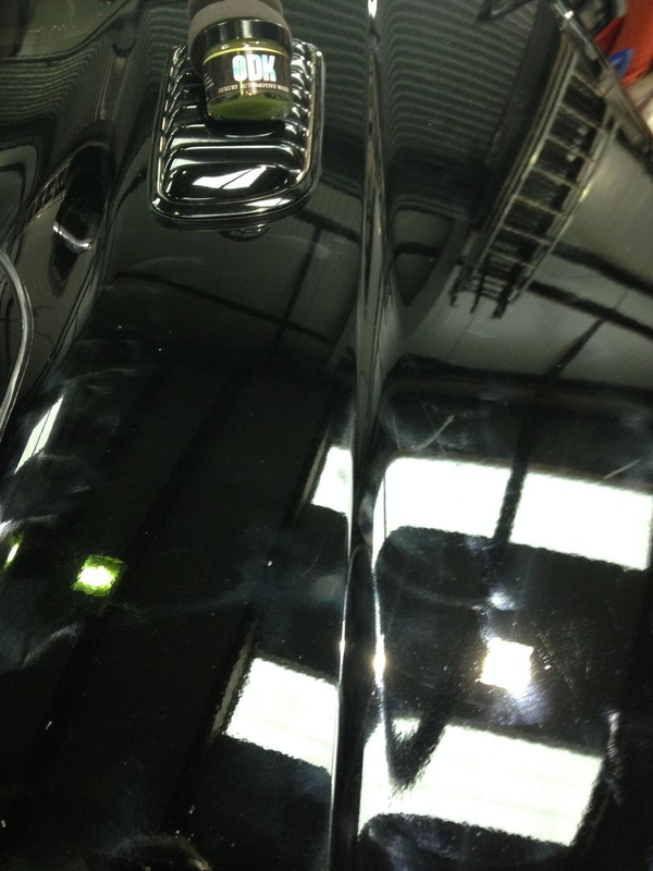

Can’t say the same about Odk Glamour it gave a brilliant finish and smelt fantastic but was a pig to apply, so much so I threw it in the bin in disgust and went back to collinite.
