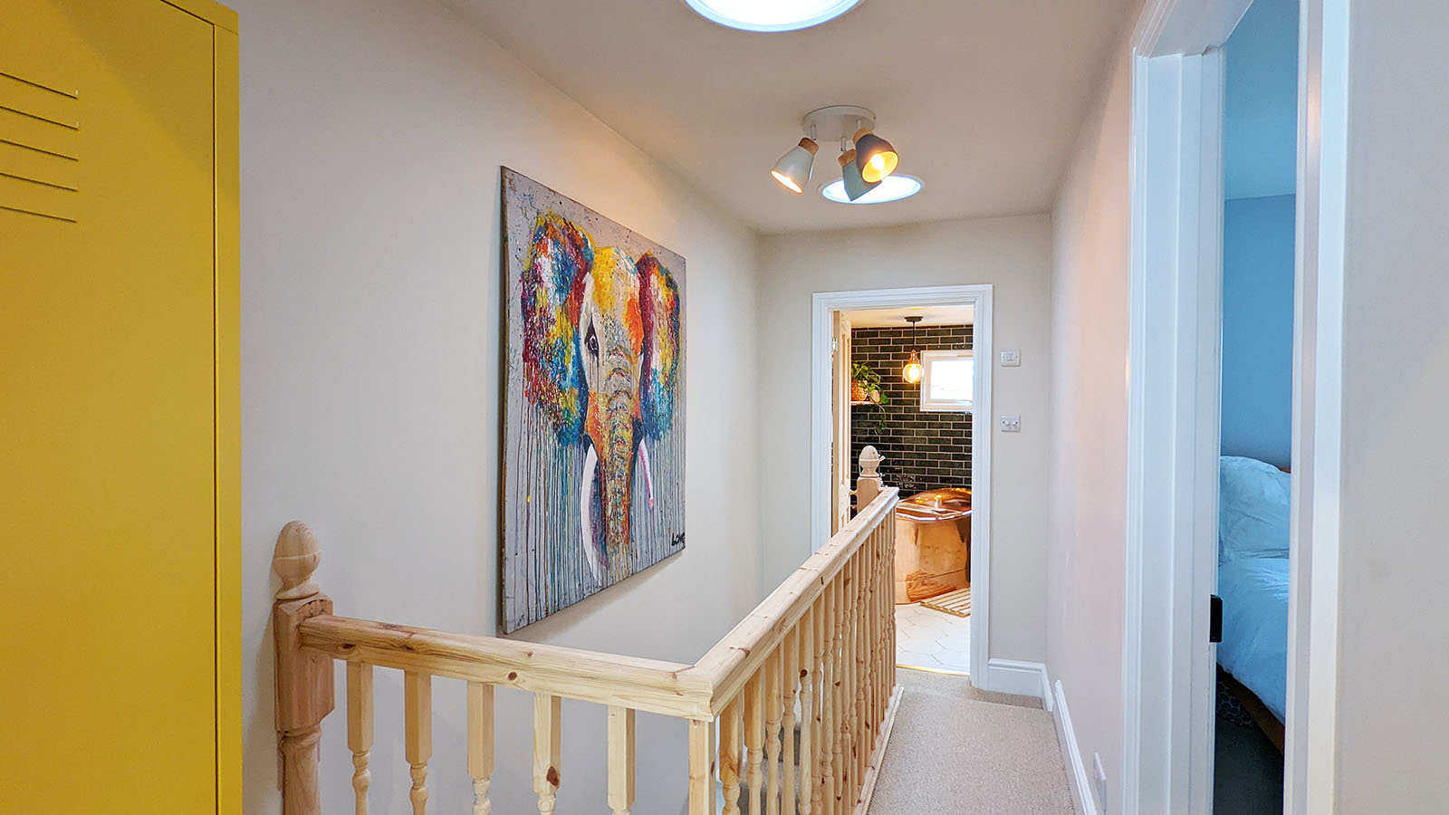

Realised I never finished this thread. Well the build finished in like September, and we're really happy with the layout and usable space that the 2 bedroom and 1 bathroom layout has given us. And the obvious value benefit of an extra bedroom.
Still some soft furnishings and shelves etc to finish but otherwise we're all done!
Very nice. Great bathroom that.
We're about to put in planning for a loft so those floor plans are very handy!
That's a great loft. The bathroom is awesome. Where did you draw your inspiration from?
Where is the elephant artwork from? That's a great size and livens up the area.
Cheers.
@Russinating - Awesome job, looks amazing and you’ve got a showpiece bathroom to top it all off! I guess there’s not much in the way of storage up there, but you’ve added two double bedrooms which is brilliant. What a difference from the initial plans!
Stunning! Have you put some sort of finish on the doors and banisters to seal them? Otherwise they will get really grubby where people touch them!

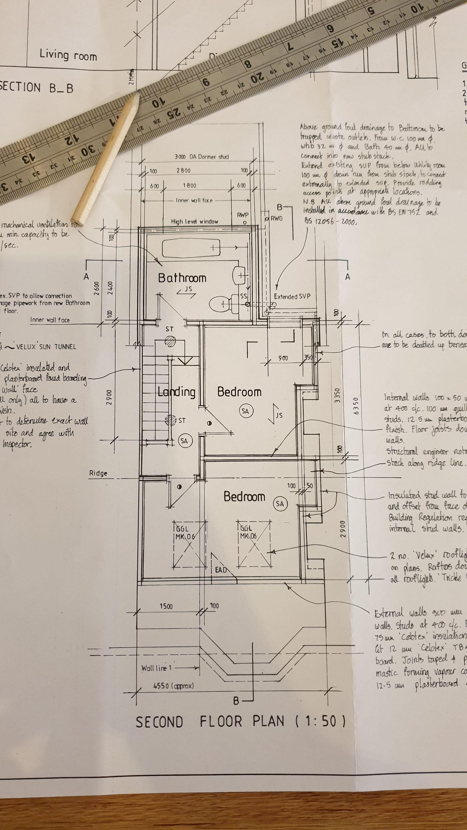

Thanks guys. This was the final plan FYI:
@Lartyconshayo Yeah they're fairly standard? Everything was from Victorian Plumbing.
@ddoubleep We viewed 4 extensions on our road and did something very similar to one of our neighbours in terms of layout and the panoramic window at the back. The views across Bristol are amazing and it's quite freeing to be showering whilst looking out!
Otherwise just life and stays in hotels etc I guess! We were set on a freestanding copper bath from the start and the green metro tiles shortly followed. We're really pleased with the bathroom, particularly the layout as we had some alternative ones to get a bath and a shower in.
The elephant is an original painting by an artist called Sophie Long. It was painted about 6 years ago live at Upfest in Bristol which is Europe's largest street art festival and we offered to buy it after. I think it's 1.2m x 1.2m on solid wood so yeah, it needs a good space!
@tom_nieto There's plenty for us at the moment. We're actually only two people but it's now a 5 bed, the 2 existing bedrooms have built-in wardrobes and the other is now a study. There's loads in the eaves but even just having 2 more beds with storage under is quite a lot! In the future we may get more chests of drawers, and the alcove bit in the blue room is going to have built-in shelving.
@a1ex2001 It's on the to-do list! That or paint them white, we're still undecided.

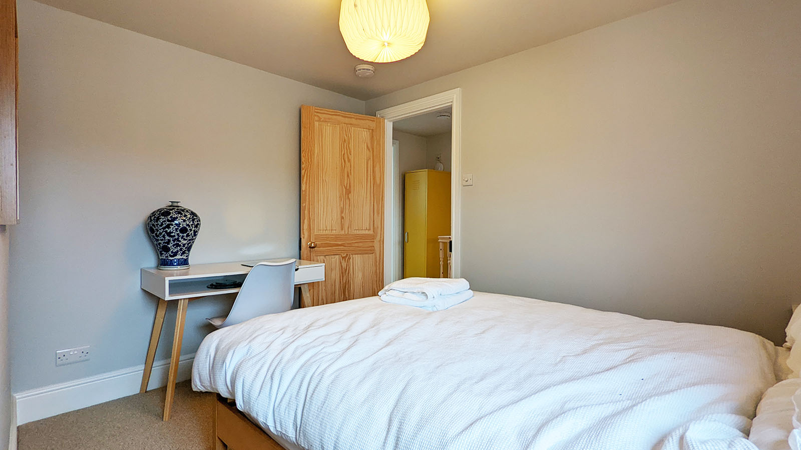

wow that looks superb! which colours did you use on that first bedroom?
Colours are Farrow & Ball's Red Earth, Setting Plaster and School House White but mixed at Johnstone's.
