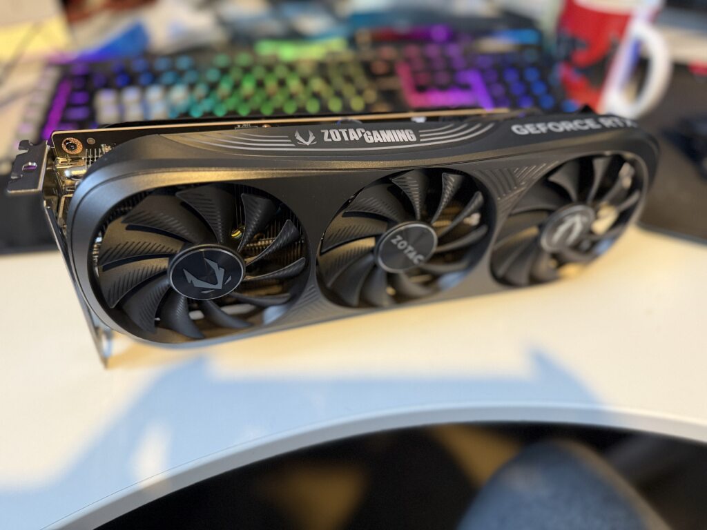

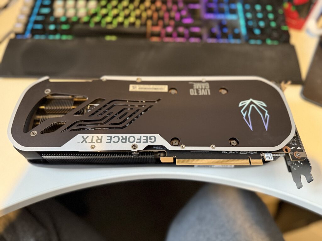

Well on Friday a mate came over and managed to part me with one of my rare BMX bikes. I have 15 in total, most at mum's. Any way that left me money to buy a GPU. I got this from the MM for 700 quid which was what the bike sold for.

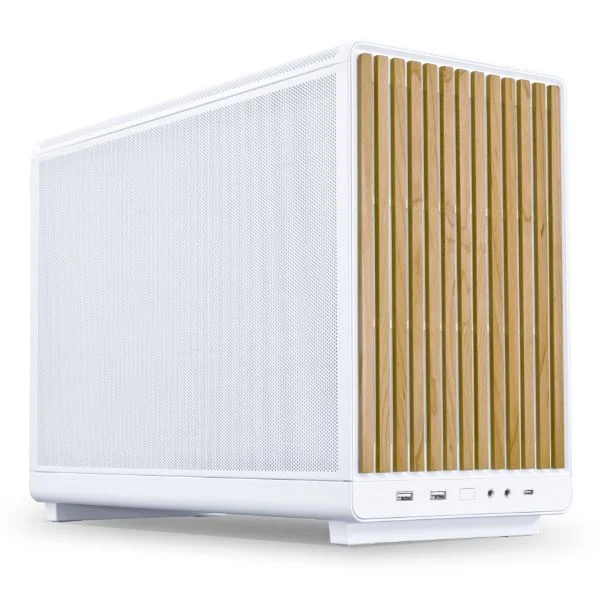

It shipped out today and will arrive tomorrow with RMSD. So now I started planning. "Do I need to upgrade the CPU?" no. A 12700KF is more than good enough. I did, however, want to drastically downsize but not use an ITX case. I've used three now and every single one has been a hot box. Started looking at cases and the new Cooler Master 200P looked about right. And then I came across this.
Which was actually cheaper. So I grabbed one of those and this for 10 quid from OCUK.

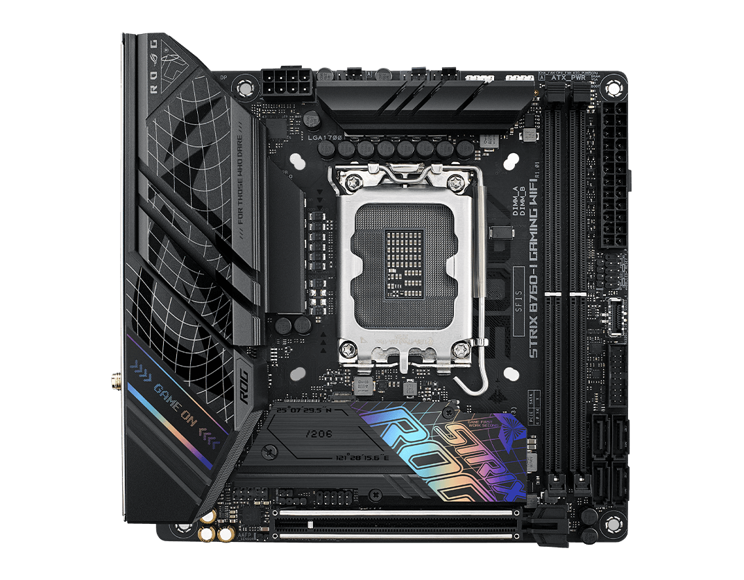

Board choices were limited and very difficult. I needed MATX or preferably ITX. Now I may sound stupid, but I put an ITX board in one of the biggest cases ever made.
"I used to be a hot box but I'm alright now"
I like how it leaves lots of space inside to work around. What I didn't particularly like was the board price lmao. 185 quid. That said it saves me buying a new CPU...

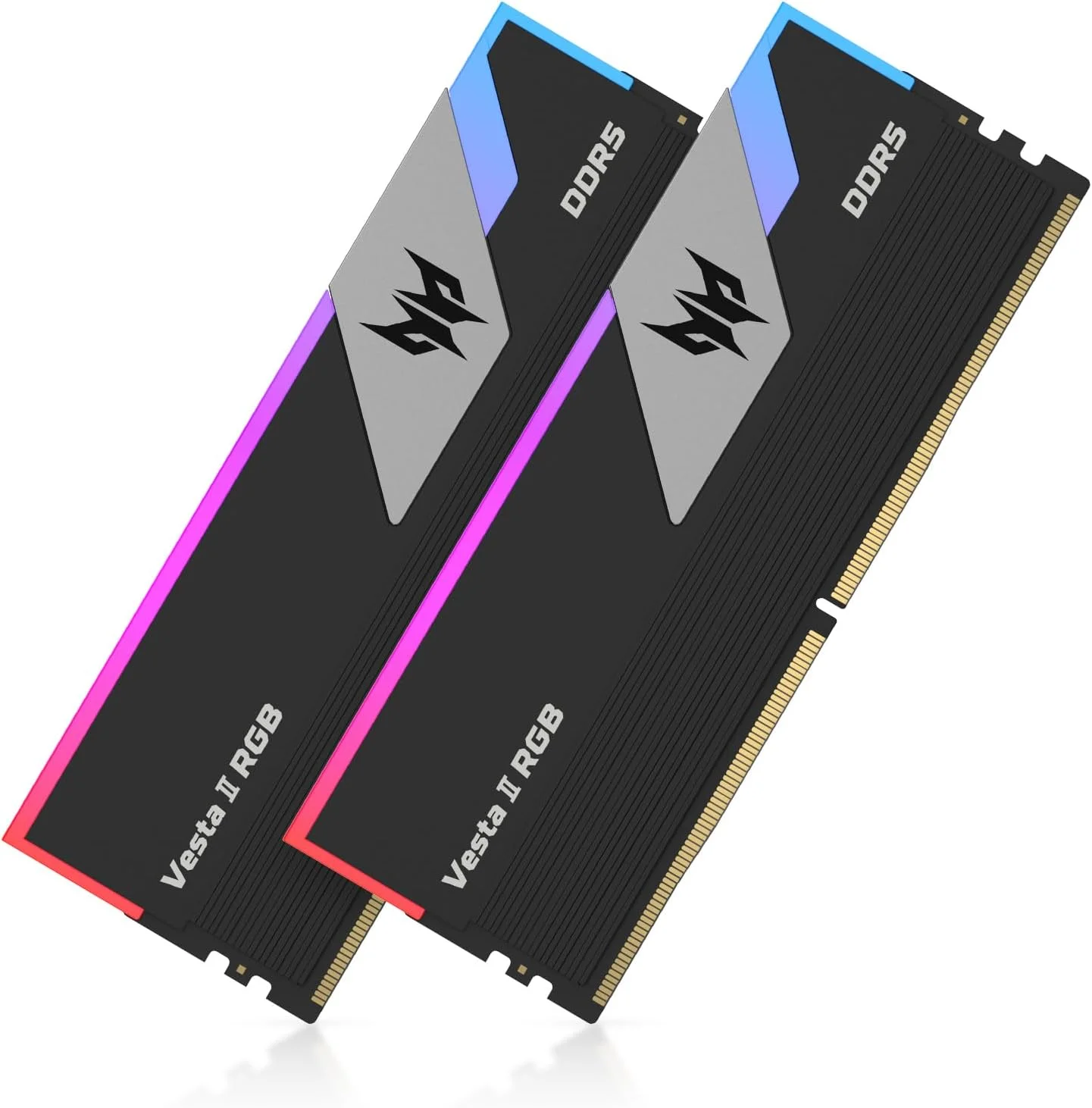

The only sod is that it's DDR5. However, at 83 quid I didn't mind as it should provide some gains at least.
Aye same as my desktop. It's gorgeous memory. OK so case board and RAM got. Obviously I could fit the old EK cooler (360) but it's old now and would make it very tight in there. Instead I decided to go air.

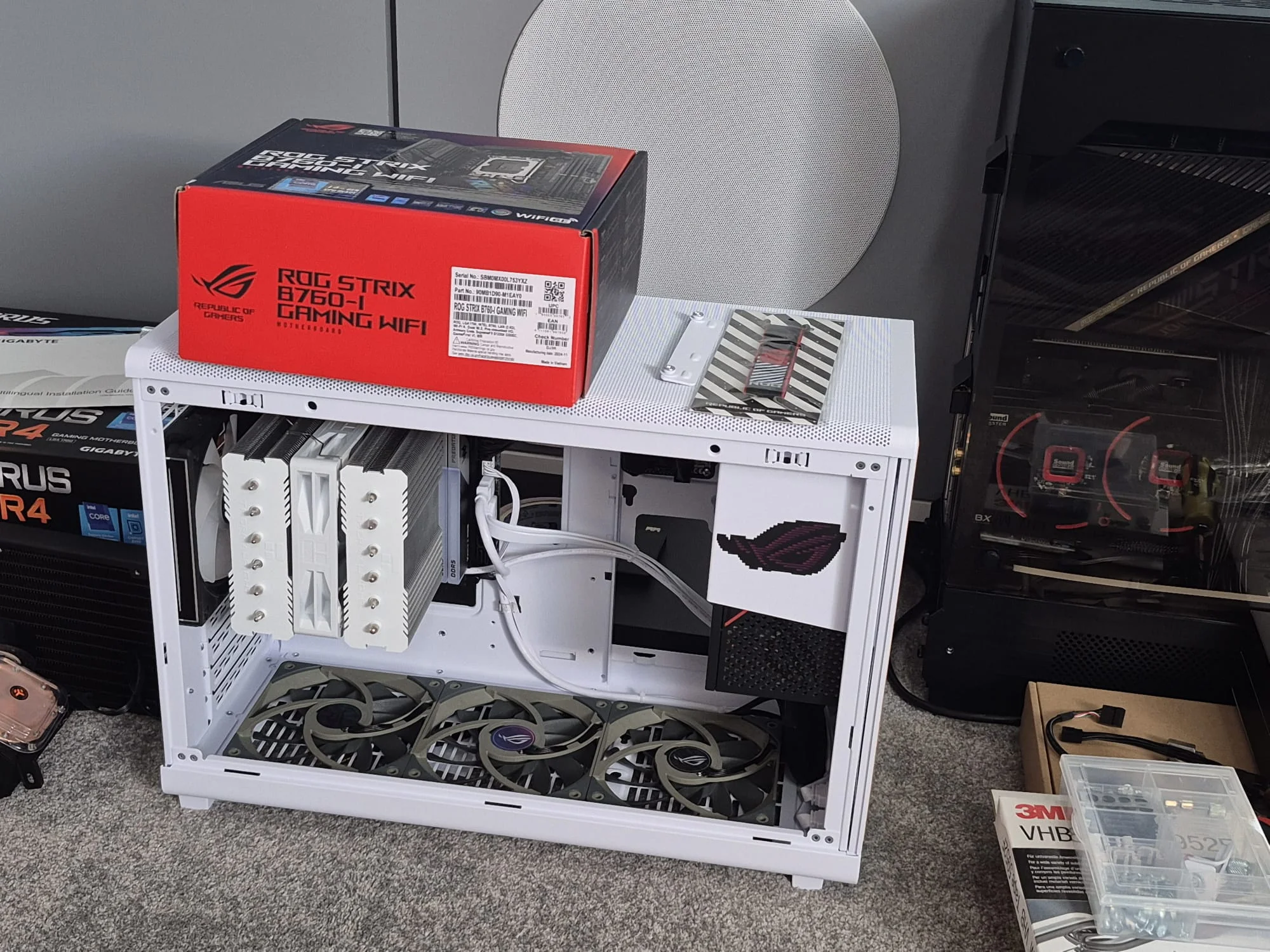

So I rebuilt that first due to waiting on deliveries.

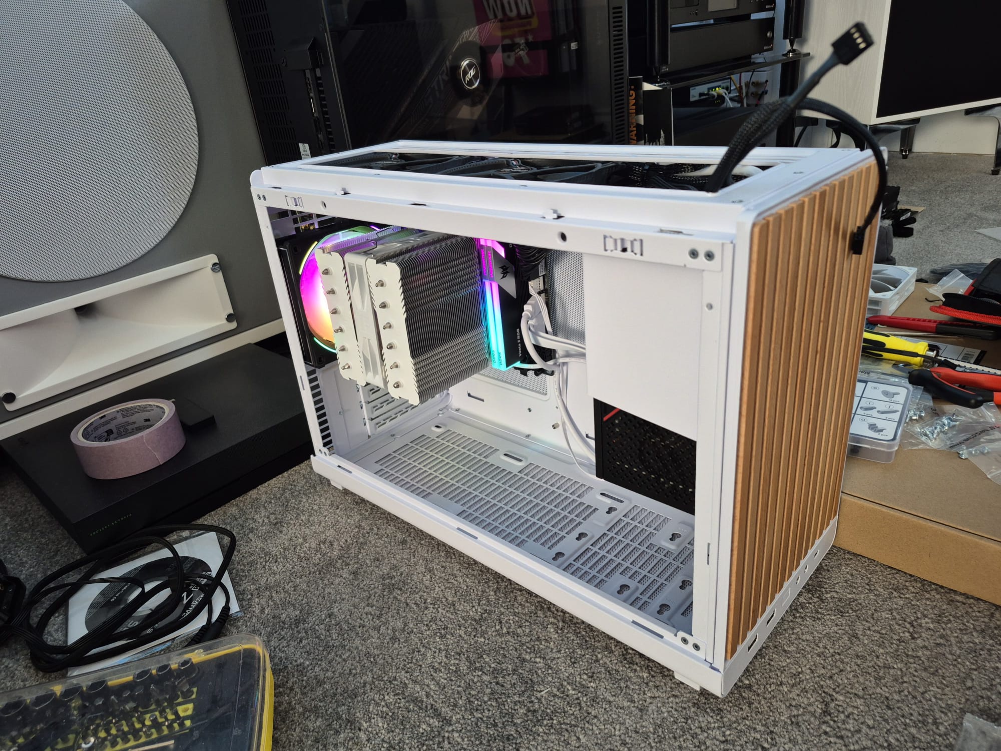

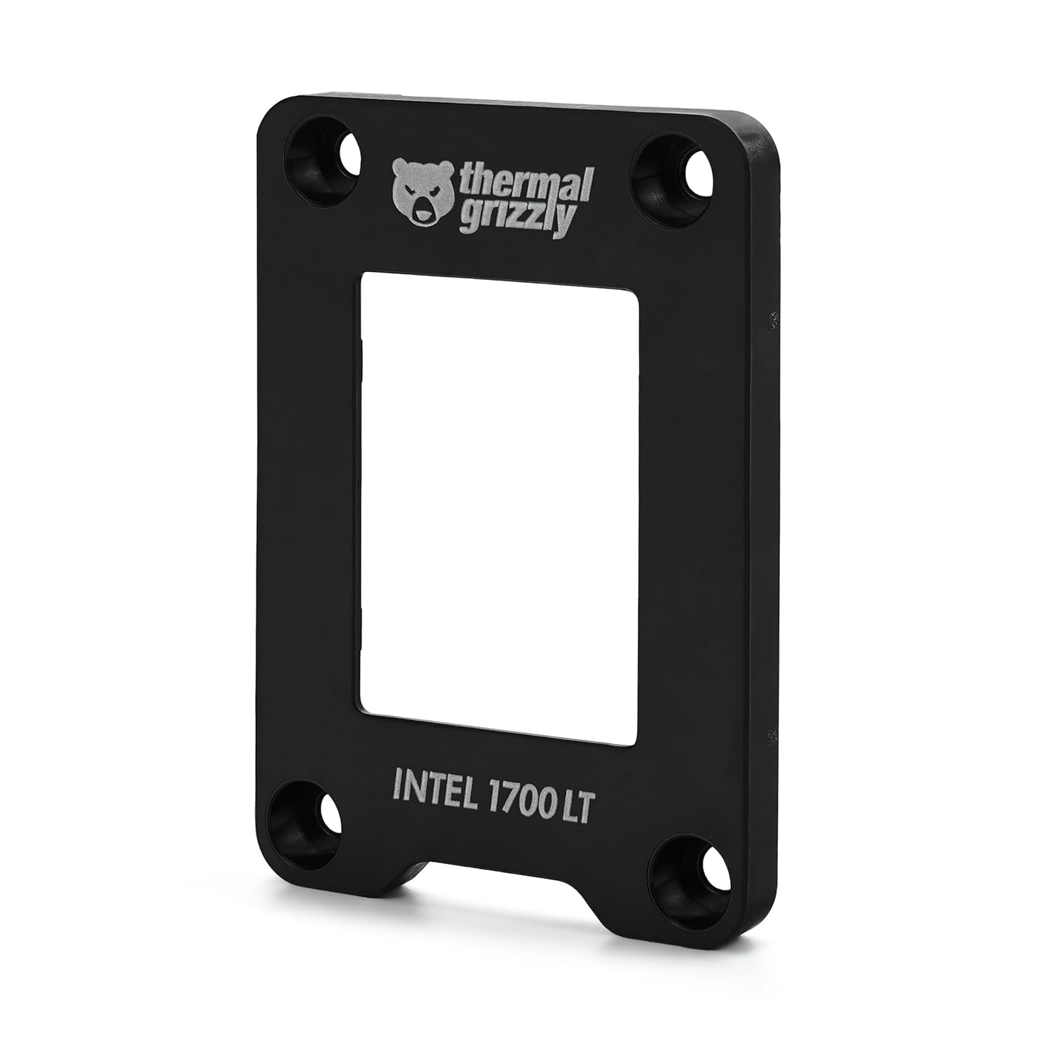

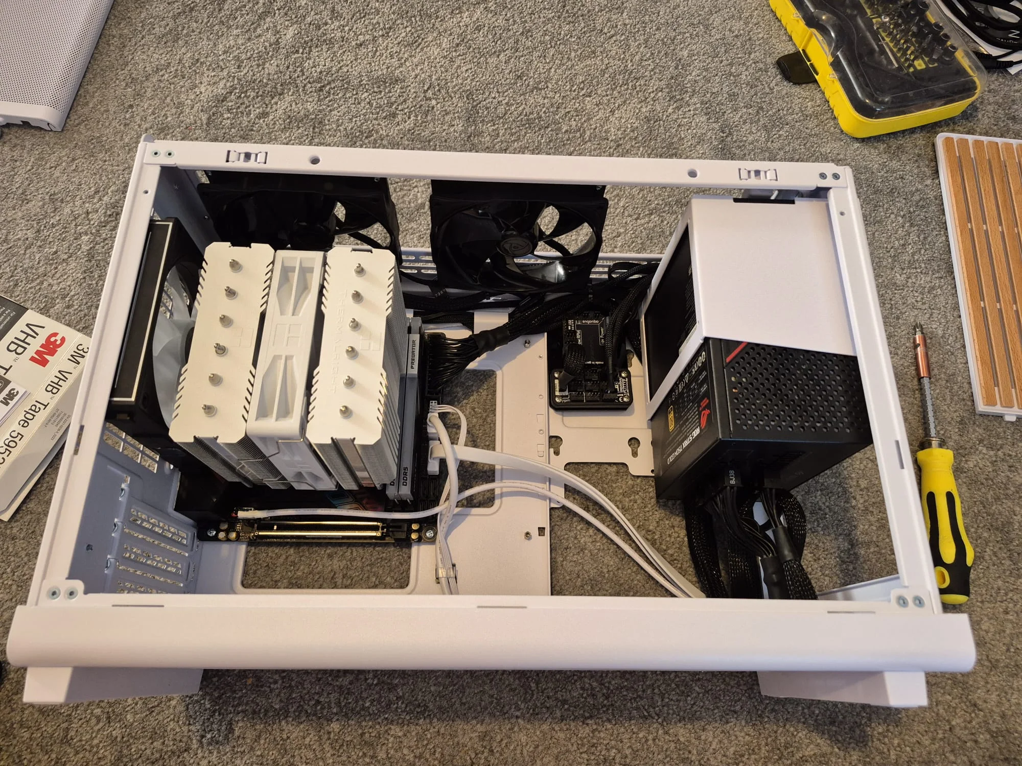

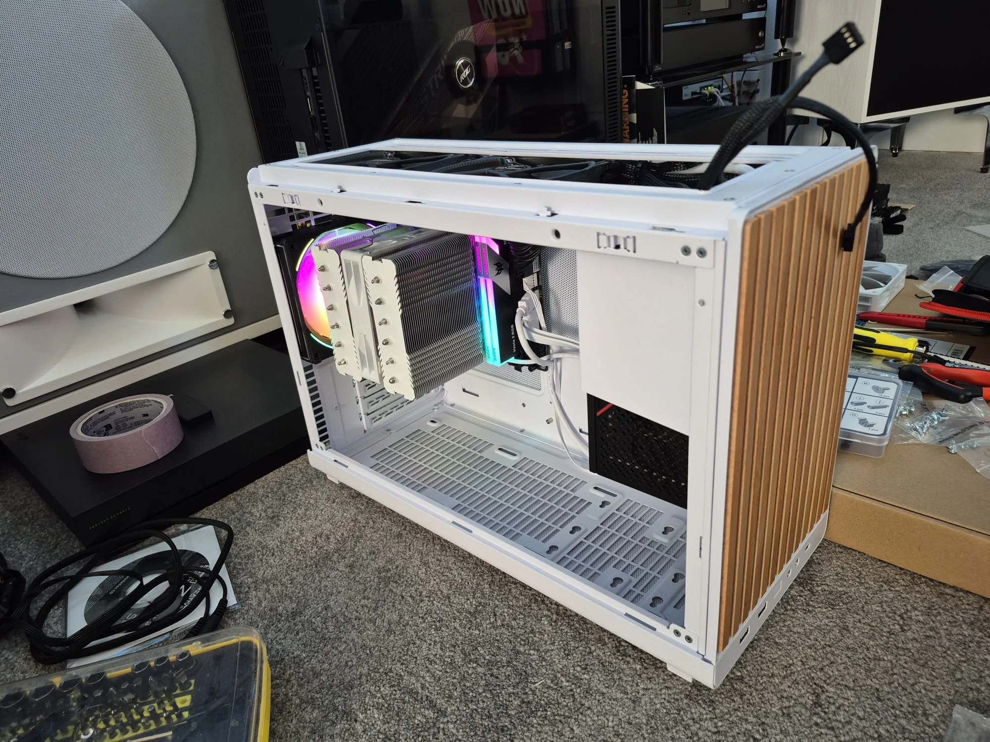

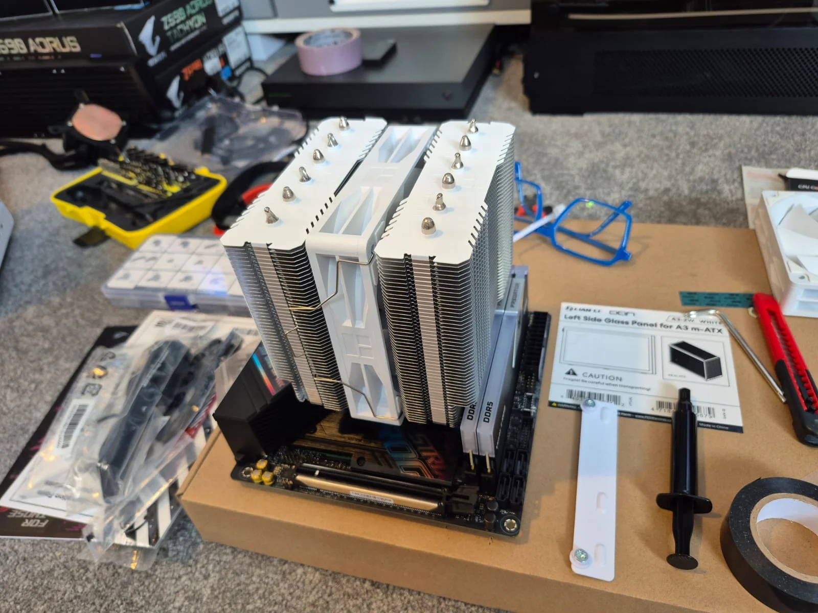

OK so Saturday DPD showed. So did the RAM from elsewhere and the contact frame and cooler.

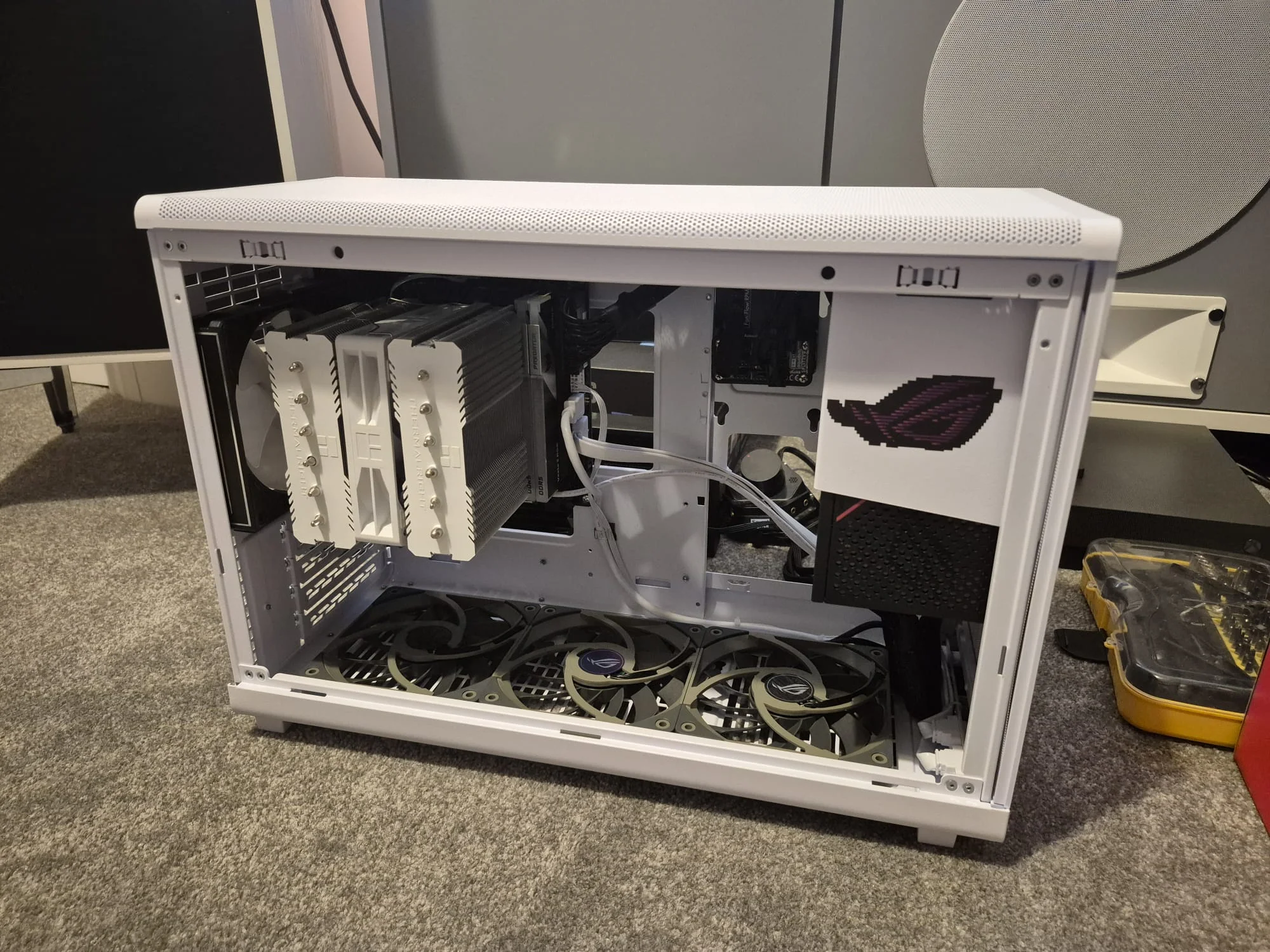

That is with the frame installed, cooler mounted etc. I then went to the case and started playing with fan arrangements.

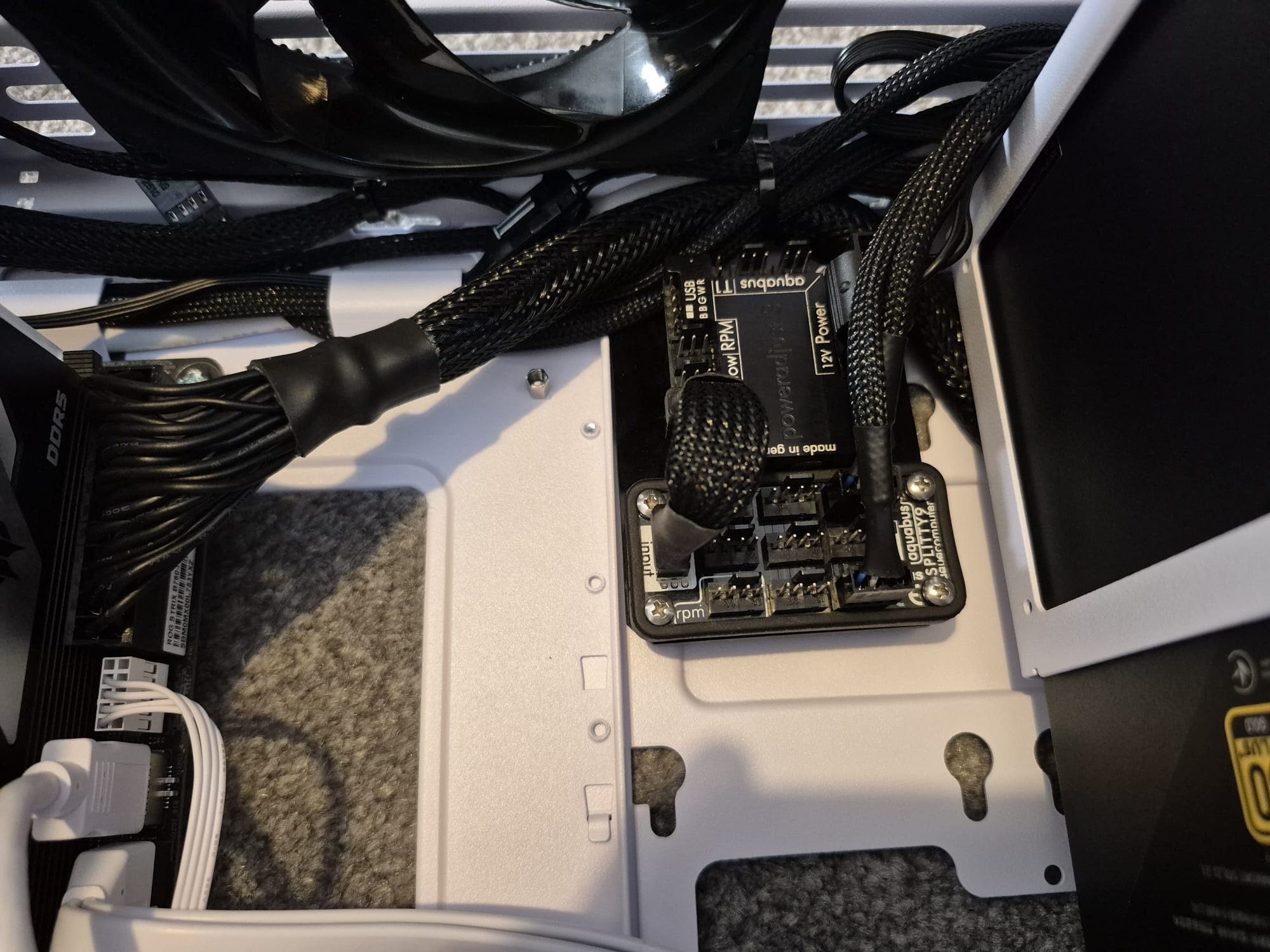

I was perfectly happy with that. I also decided to fit my PA3 and Splitty so all of the case fans behaved. So in it went along with the board.
And.
I routed the cables around the front of the PC, into the top and then tied and ran to length into the PA3.
Obviously no onboard but I did power test it and it started OK. RAM RGB sprang into life which is usually a good sign IIRC.

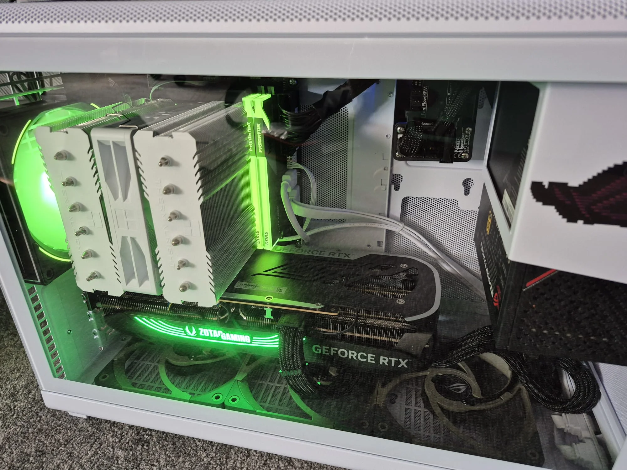

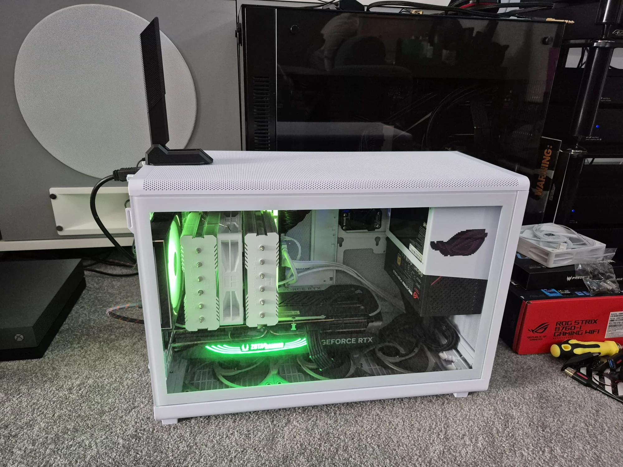

And this is where I am now at.

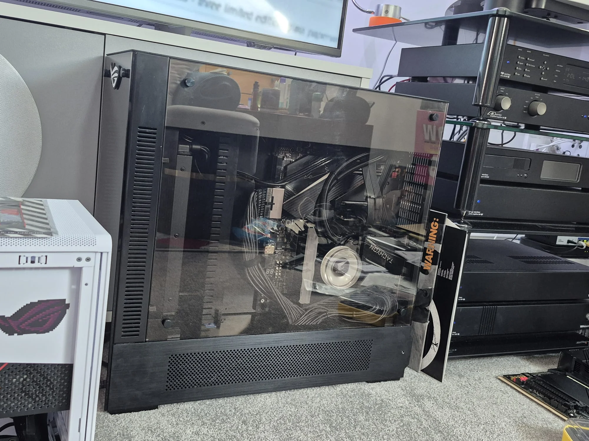

You can see the PC it is replacing. This is the other side of said PC.

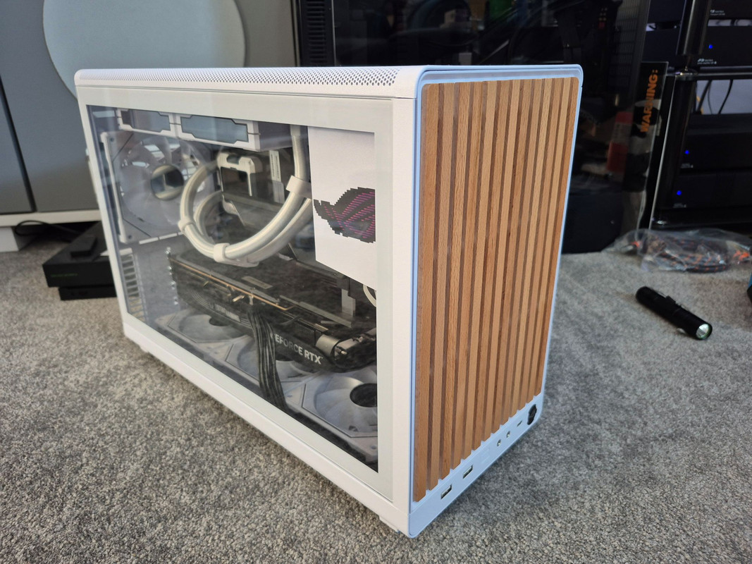

Overall I love this case. It's a dream to work in. Someone on the OCUK reviews said it was bad because the bottom slot was blocked on the MATX GPU, but that's not the cases fault it's just how GPUs are these days.
I will update tomorrow when the GPU arrives. I also ordered this.

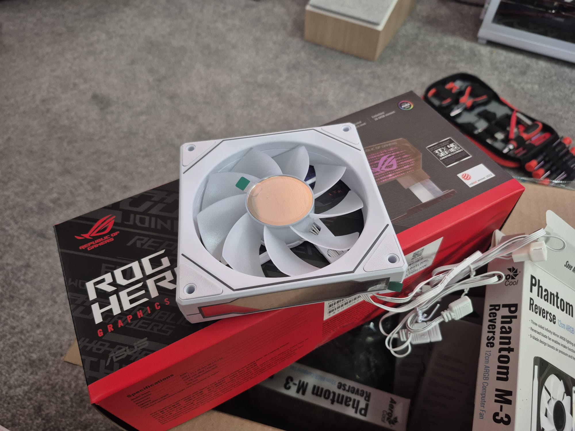

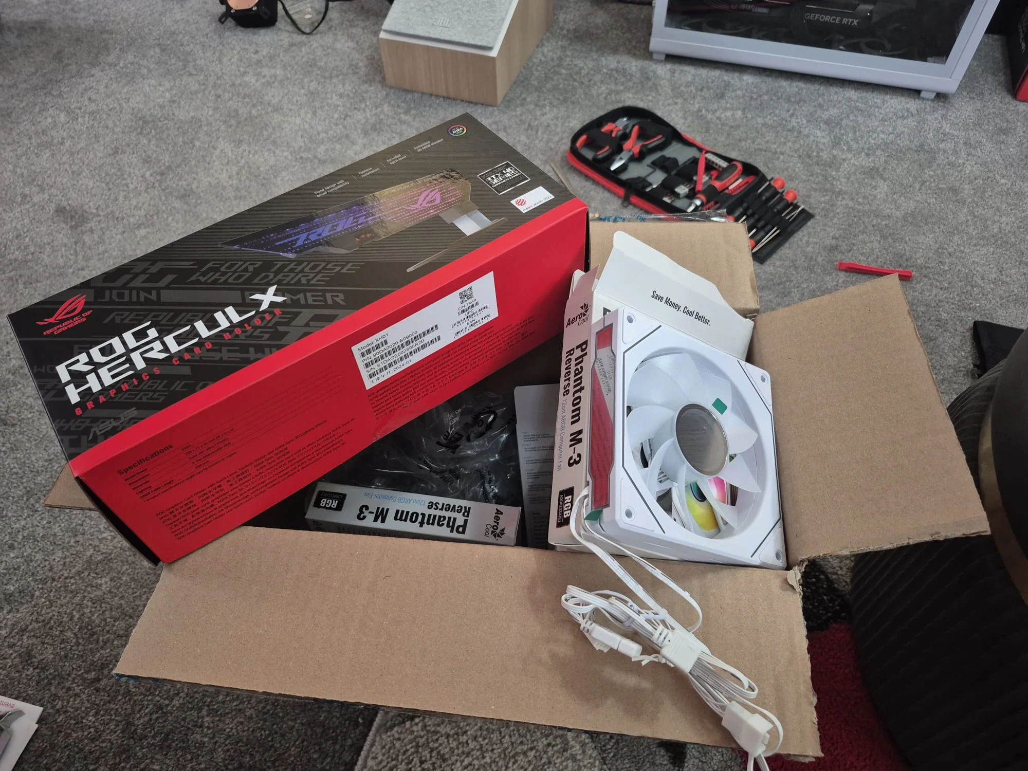

OK so I decided to buy a couple of bits. After realising the GPU was not stupid big I realised I could fit normal fans in. These were a fiver each and reverse flow.
I got 5. Then realised that reverse flow were no good for the top lol. I will put 3 in the bottom and one in the cooler in the correct direction. I also grabbed that ROG Herculx. That will stand on top of the GPU and cover up the wires whilst adding some RGB. Just basically as a light panel.

GPU stand didn't fit where I wanted it to but does look good. Going to do more but not until I've got this health stuff sorted out.

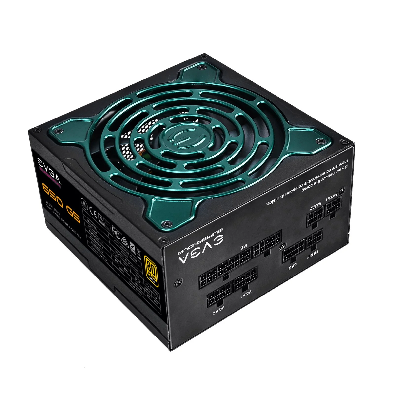

OK so I decided to change a couple of things as well. I'm not happy about putting a 650w PSU into the PC I need to get back up and running. I think it's not enough for an 11700k and 6800xt. So I am going to put the PSU I took from it (the Strix in here) back in there. I got this for the white PC.
It's used, but was only 145 quid. The good bit is it is compatible with the 12vhpwr cable I just got, being Seasonic the same as the Strix. I also bought 3 more of the Aerocool fans for a fiver each to replace all of the non white fans in the rig. Oh and this. I found out the 760i does not support MSATA so I need another drive for it.

This case however? is quite lardy for a small case. However, it sacrifices absolutely nothing. The pun on the box is hilarious, stating in quotes "The compatibility is strong with this one !". It's also amazing how tidy you can make the wiring when it has practically no cable management.

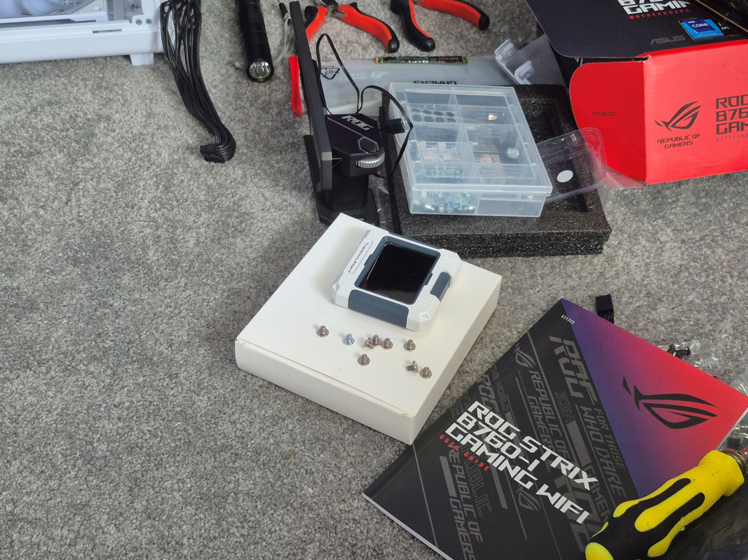

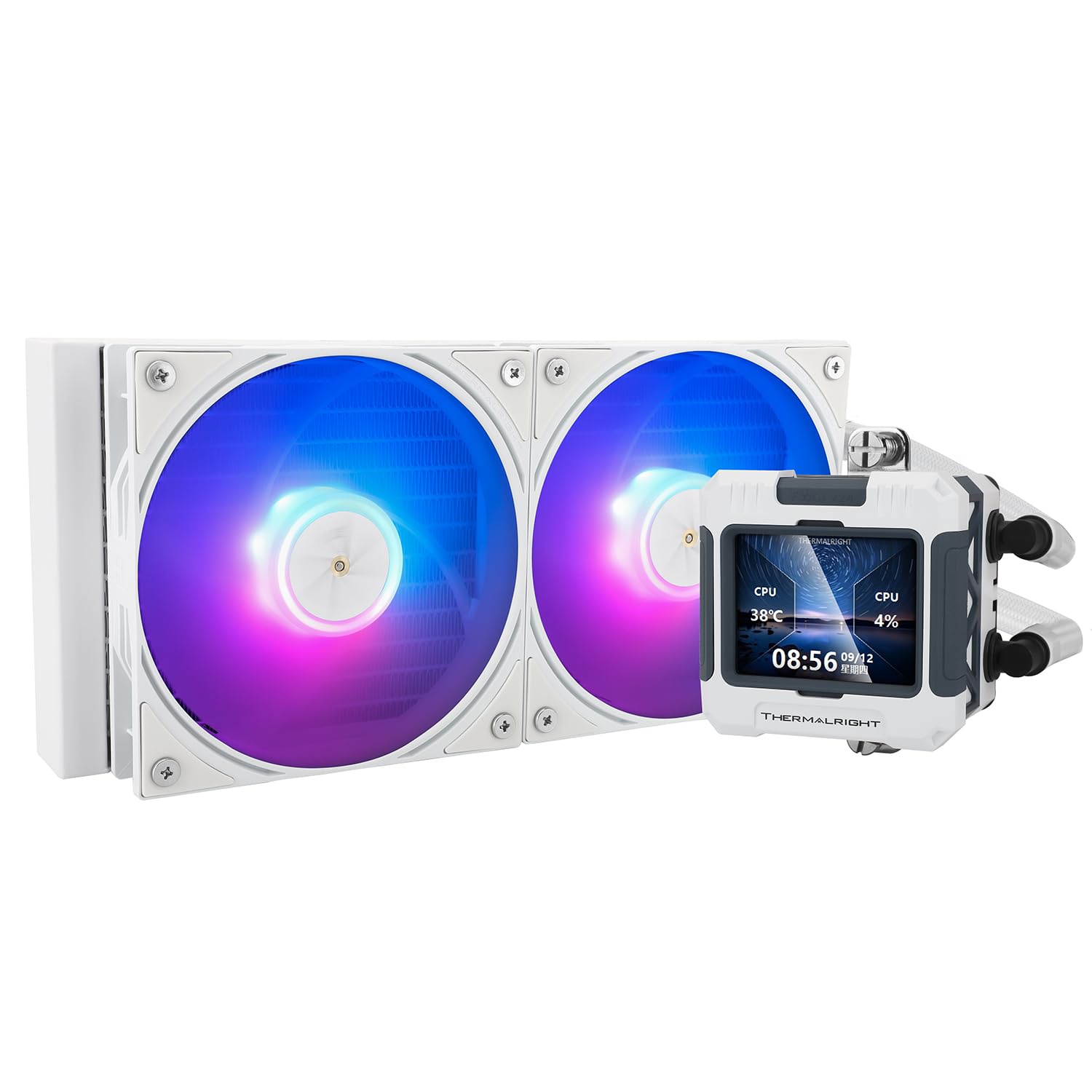

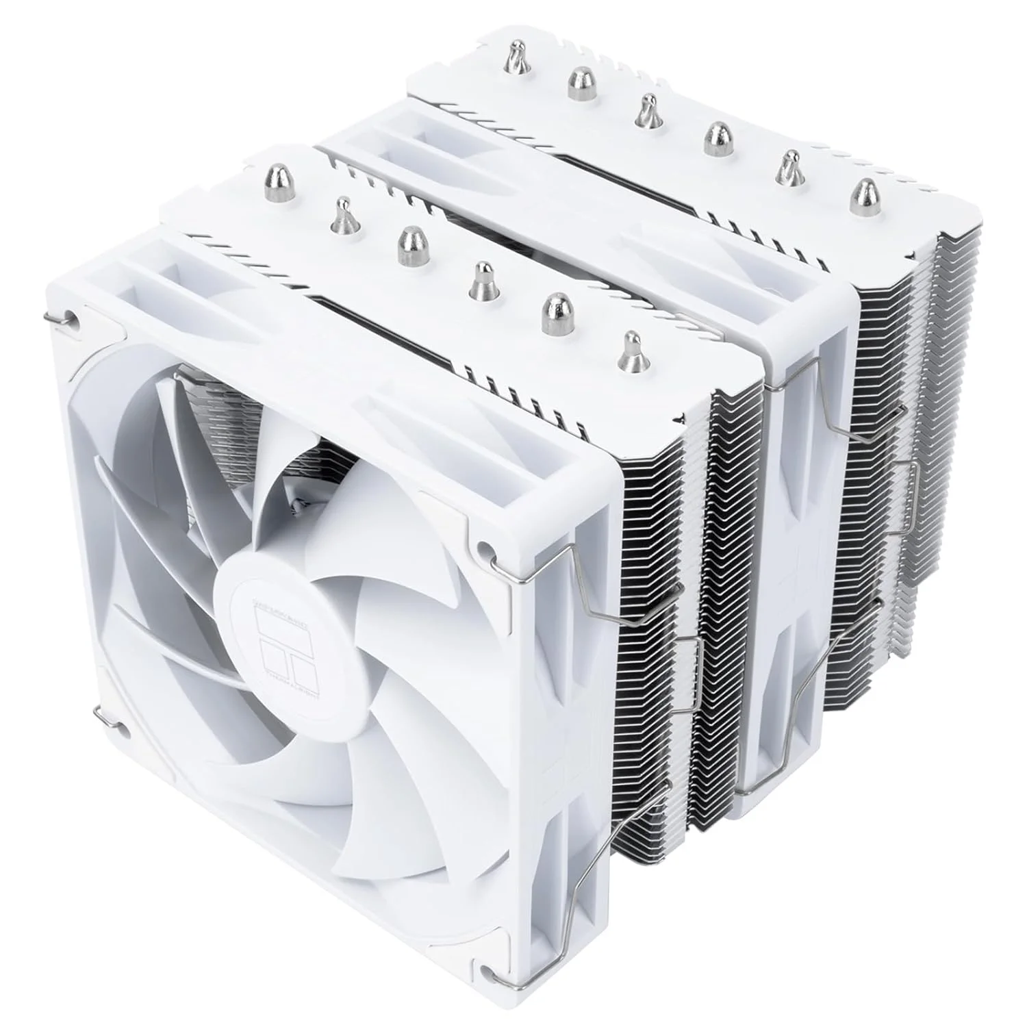

I don't like how the cooler blocks the RAM, nor how fitting a second fan onto it would make it look daft because of said RAM. A few days ago someone asked me about which AIO I would get these days and as usual it ended in one word. "Thermalright". Whilst digging I found this.
For £62. I mean seriously if that were made by Asus it would be £300. So I got it.
Thermalright really putting some well needed pressure on the market with those Coolers ATM, That one above looks fantastic for the price.
Just shows how the "big" brands really rip us off.
The funny bit is it's mostly Thermalright who make their coolers.
Talking of the cooler. It arrived yesterday. So did the Loki. I will be going home tomorrow and if I know me I will get stuck in tomorrow evening lol. The fans from OCUK came also, so I swapped out the ones on the rad already. No point in taking more stuff home I don't need there.

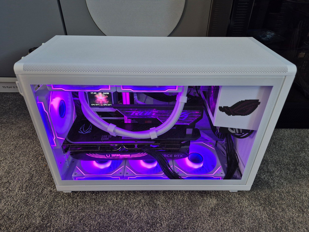

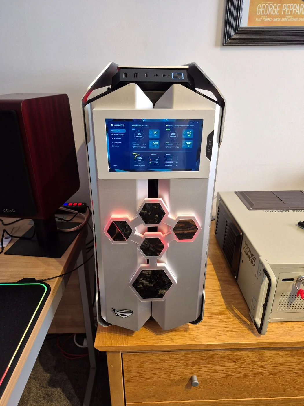

The PC is now finished. Sadly Imgur seem to no longer support forum pics, so I can't post any. Will work on that at another time.

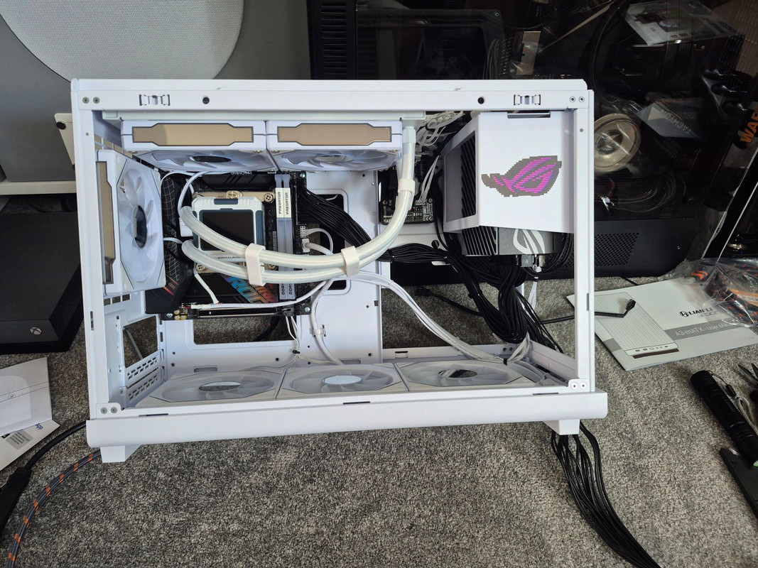

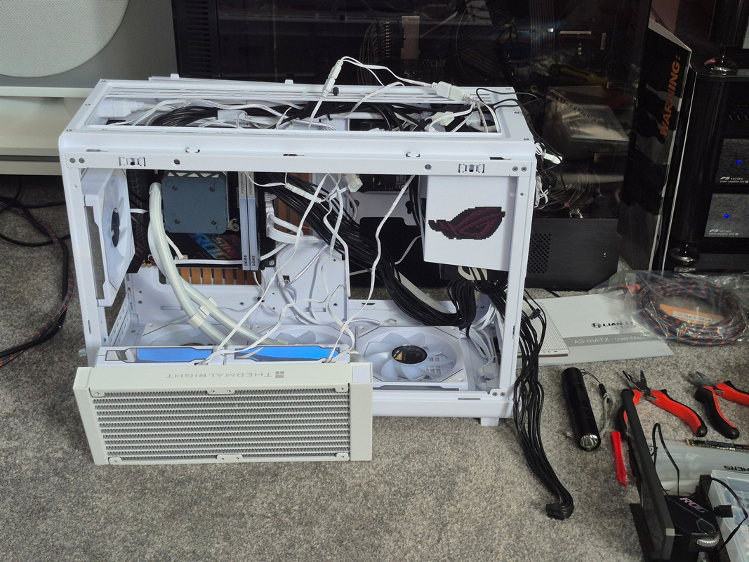

OK. So I managed to get this far on the first day. Unfortunately I made some mistakes and the rad had to come out several times. I threw in the towel around 11pm. It was hot in here too which was not helping.
I do like how the screen is detachable though. Very cool.
OK so starting the next day I got it all pretty much done.
Before finally.
Good news is with the air cooler gone I could use the ROG thing to cover up the messy junction of the cables. Worked very well ! There is only one more thing I want to do. In the pic below you will see like a key chain thing they gave me with the mobo. Initially I tossed it to one side as junk. However, I then had an idea. See, to get the front off to clean the dust filter you have to remove one side and usually the top. Which is annoying. So I want to cut off the ring and connect it to the top of the front panel on the outside. I can then use it to pull off said panel to clean it. I will just need to machine a cover to hide the ugly self tappers. Easily done :)
