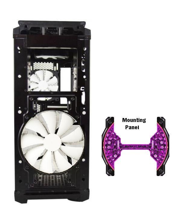

I know lots of people with Primo, Pro and Luxe systems using the stock fans. Only complainted I've heard is the 200mm front fan in Pro & Luxe can be noisy, but I think that is more to do with all the mounting framework over fan for 140 & 120mm fans. If I ever get my hands on a Luxe I plan to modify the front and find out with something like this. Coloured area is what is removed from 200mm fan opening. ;)
