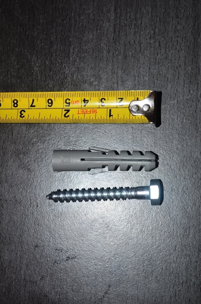

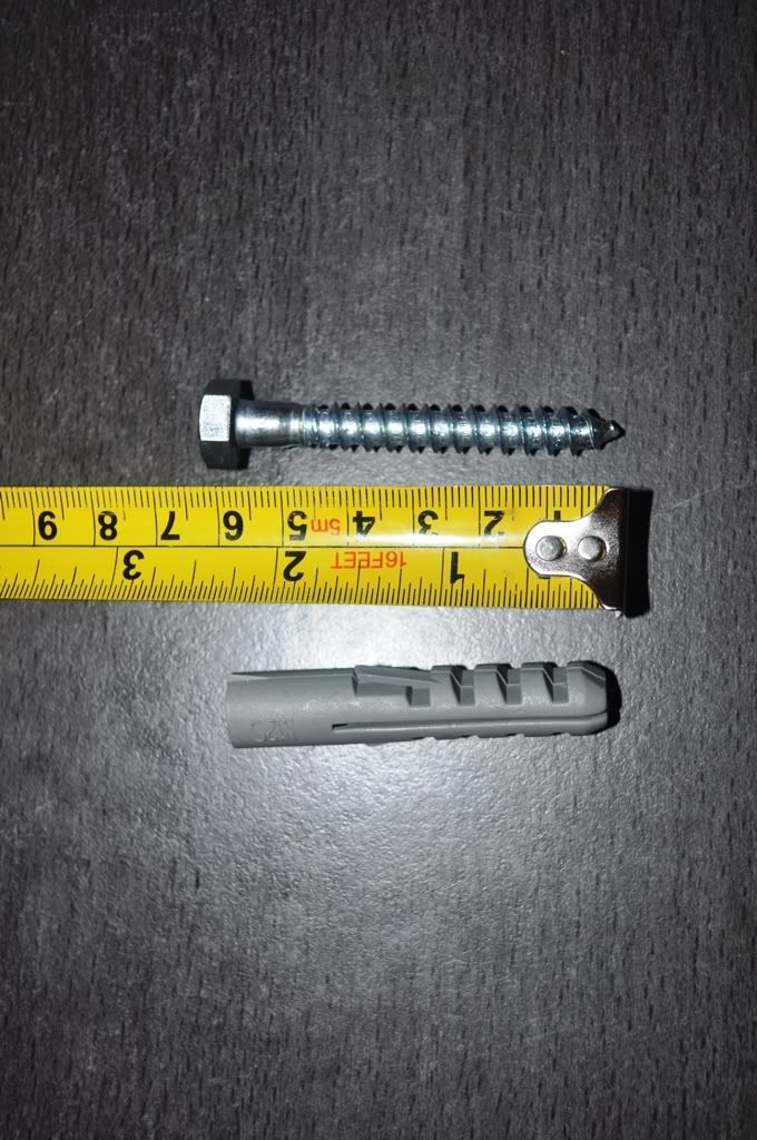

yes check this out:
it is going into a concrete anchor...
So drill as deep as about 5cm, and use a maximum drill bit width, that by eye, is about the same or thinner as the wall plug, the screw going into the wall plug will cause it to expand and grab the bricks with those barbs.
70mm not 7mm.
I would drill a pilot hole as well, the bigger drills will tend to skip about a lot without a pilot hole.
so do you think m8 coach screws would be more secure in my block wall
or
do you think the bolts and concrete anchors in my pic will be okay?
they "is" blocks
I aim to make it a tight fitting - prob 5-6 cm deep
Use what ever the kit says and always use what ever the kit says for drill size bit.
exactly - that's the problem kit says "not intended for cinder blocks or steel studs.." lol - that's why on the other thread it was mentioned to use m8 coach screws.
