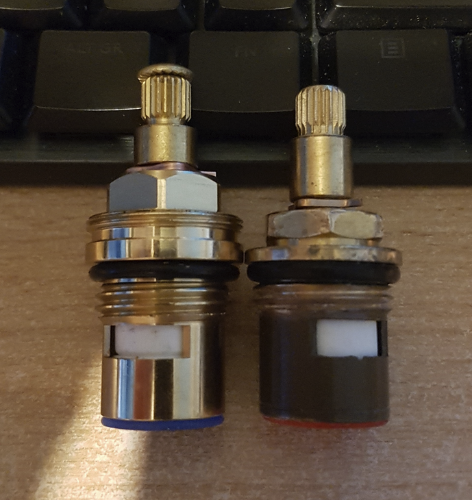

It was getting late and I really wanted to try something so just said **** it and went back to screwfix (had to validate my car because for a private car park in a little area with tool shops you can only visit once per day unless you validate so I did and recorded myself doing so) and picked these up as it looked like the bit at the top was 8mm.
I just thought maybe I won't find a 1:1 lookalike so went with overall dimensions and slapped it in, no more drip so said sod doing the cold one right now ill just wait til that one starts playing up itself lol.
New vs old
Ill see how it goes and have a punt at cleaning the old one up but it looks like as you turn to close it there is a slight gap in the plastic as well.
Nothing out of the ordinary has been seen since and the dripping has gone, nothing dripping from the handle side to indicate any leak issues so fingers crossed its sorted.
Don't know how long we may have these taps for so may go buy another bag or two just incase.
