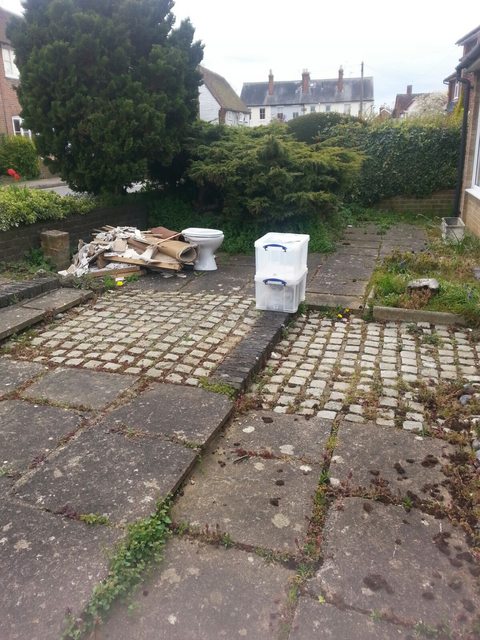

Afternoon all - the time has finally come for me to sort out our front driveway. We've lived in the house for 3 years now and my wife parks on the front grass and it's starting to feel all a bit too *****.
I've only got a streetview image from before me moved in (The area has been tidied up massively since the Google Streetview picture was taken);
The area is 6m*2.9m.
Ideally we wanted to extend the block paving across but the few quotes we had about 18 months ago just came in too expensive for it to be worthwhile (we're planning on moving in a few years and my wife hasn't minding parking on the grass). The main reason for getting it sorted is just for it to look nicer.
With all of the above taken into account and my preference for making it look nicer for as little cost I think we've decided to put gravel down. Plenty of other houses down the road have gravel driveway so it won't look out of place, it should be cheap(ish) to complete and won't take much time.
What am I looking at to gravel the area? I'd like to do the work myself (or with friends) over one weekend and think I've got a rough idea of the plan;

None of this is in anyway related to the thread. The fences have been changed (I specifically mention that the photo is over 3 years old and has been tidied up since then). Not interested in moving the drain cover. We already have a garage (round the back with car access). Don't want to block pave the grass bit due to cost.
I am specifically looking for advice and help with replacing the grass with gravel.
