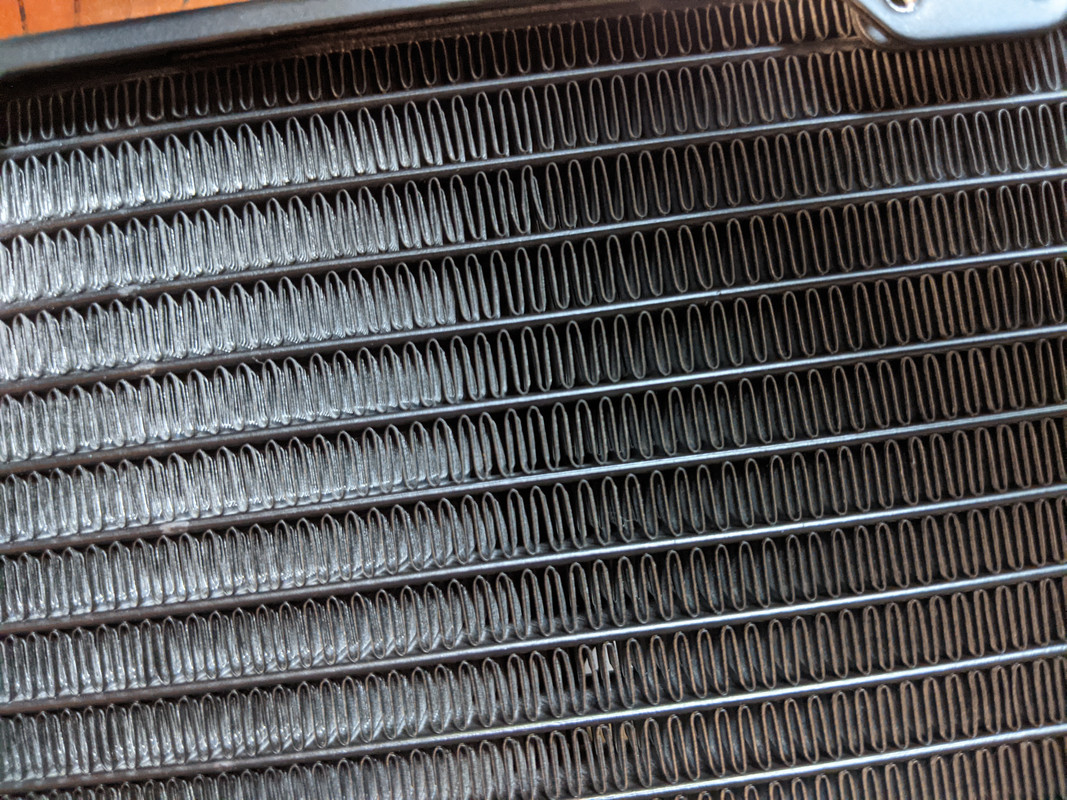

My Wife's PC needed cleaning out anyway.
So, before:
After, with a little brushing:
Wouldn't pass for new, but it is actually clear.
