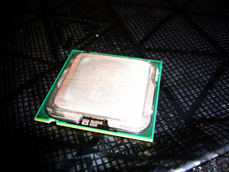

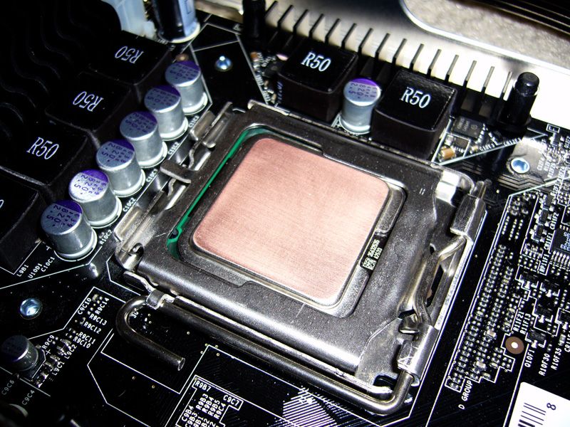

Well I decided yesterday that I would have a crack at this
I heard a few people had managed to drop there core temps by 10oC but most people seemed to get about 6oC drops
Set up as follows:
E6600 @ 3.1ghz - 1.4v
Thermalright ultra-120 + 120mm fan
AS5 paste
Anyway I have to say im a little disapointed in my results but there was a definate temp drop using Intels TAT
Load using Orthos - 52/53
Load using Seti - 50/51
Idle - 45/46
All taken with central heating on today and no windows open
There is definately a 3-4 degree drop all round there from what I had before... still I would have thought it would have been a little more :( oh well

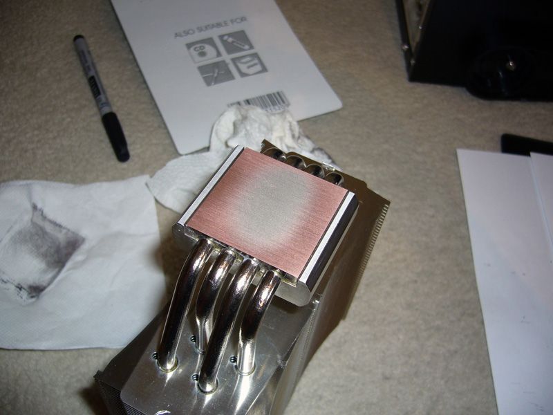

I used my icemat as the flat surface covered with a sheet of paper to protect it and then 400, 600, 800, 1200 grit papers.... I could not get 1000 grit anywhere
Here are some pics anyway

now that is shiney!!

I thought that until i started to lap,base was not flat :eek:

how the hell did you get a shine like that on the CPU :eek:
